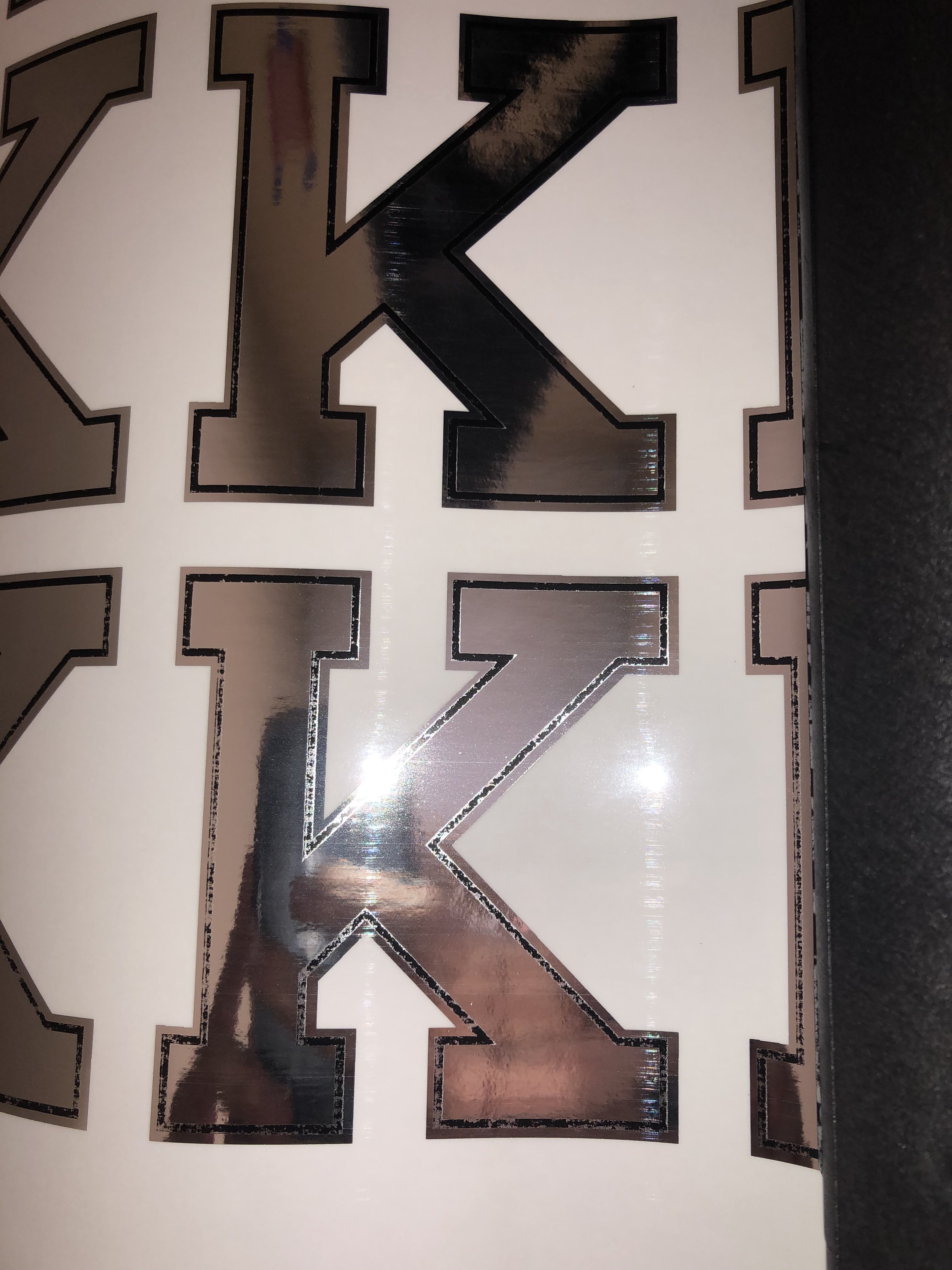

Hi,
I am printing black over chrome silver to make a decal for some cars and I ran into this issue when I printed them off.
does anyone know how to fix this, what happened, and what I need to do differently?
thank you in advance,
Will
Joe House
Sign Equipment Technician
I don't think chrome silver foil can be overprinted. You'll have to turn off the overprint on your black so that it's printing directly on the vinyl. If you have registration issues, the trap the black with the chrome.
Good luck.
Joe
Billct2
What Joe said and you may want to print the black on a darker setting. I usually print on chrome vinyl, though even edge printable chrome vinyls can have issues too.
