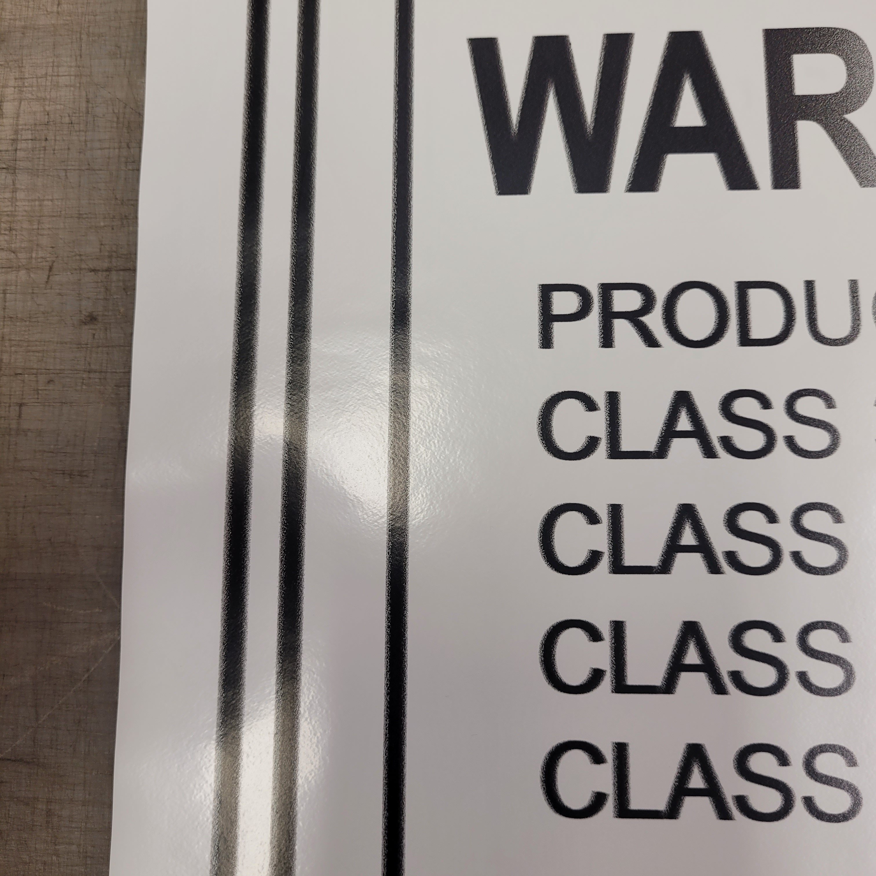

My HP 115 was printing perfect today then last print was little blurry so did printhead cleaning, and nothing. Replaced optimizer ink and nothing. Then tried again and became worse
Print test is good so bit stumped.

It's an alignment or feed issue as you have the defect only one way (sideways on this, not up and down).
You didn't say which way this came out so.... might be feed issue as 115 doesn't have OMAS to account for that.
This was printed horizontally so defect is up and down -- just took the photo vertically
Also just realized that it is printing anywhere from half an inch to full inch shorter - a 36 inch decal is 35 inches; 22 inch is 21.25 inches; 24 inch is 23.25 inches

Have you tried turning it off and back on again? I guess if there's no OMAS, reloading the machine isn't necessarily a fix, but it would be the first thing I'd try.
