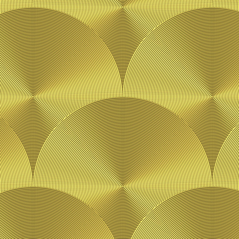

SignManiac
Alien Skins plug in. "Impact" is the one then select brushed metal effect. You can set your size to any radius.
Forgot to mention...Check Fred's stuff, he probably has one there already.

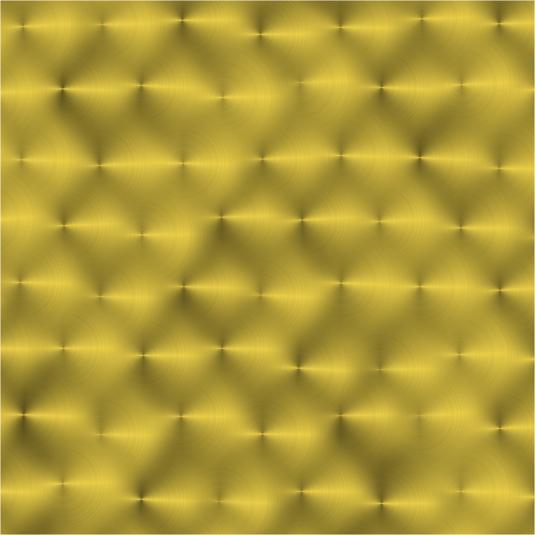

Here's a close up of one of our Engine Turn seamless tiles. You could print it directly on gold or clear as you suggest either as is or with the color lightened in Photoshop first. The scale is very easy to adjust to your needs just by reducing the size or by first defining it as a pattern in Photoshop and then using the scaling slider. The pattern itself in the seamless tile (not the closeup shown here) is infinitely repeatable so your final quality is very good.

Fred, that's some nice quality engine turn.

I don't see how printing this in any way would make it "turn" as real engine turn does as you look at it from angles... does it?

Engine Turned refers to the finishing of metal with a machine turned pattern. I've never heard it described as an effect designed to look like it is actually turning. So it seems to me that what you're describing is the way the pattern would react on a reflective surface such as shiny gold. If that is the case, then you probably would get a similar effect by printing the engine turned pattern shown earlier in this thread onto shiny gold instead of simply white media. I can't say for certain since I've never tried it. Perhaps, Kalvix or JR's could give you a better answer.
Si Allen
Printed engine turn will look like the real thing ... BUT ... will not "move" like the real thing because it is not 3 dimensional.
Printed will work nicely as a presentation, but not well on a vehicle.
"Gold is gold and paint ain't!"
:omg2:

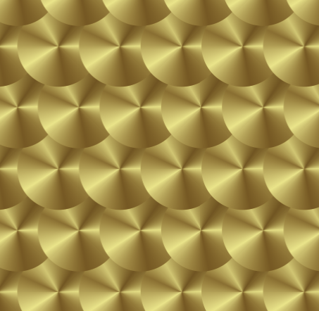

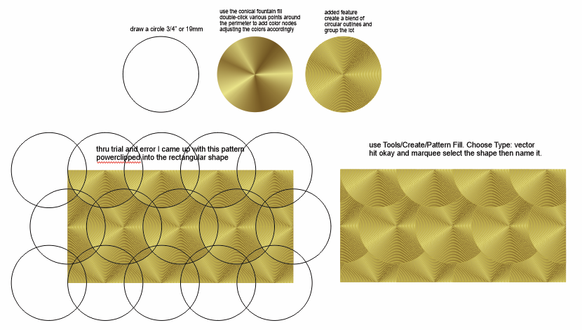

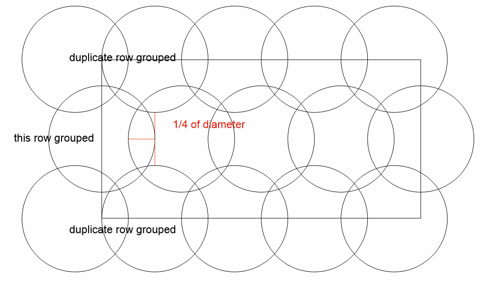

Don't know about illustrator but I created this vector fill pattern for Corel. Can customize to any size needed.

Thank you, I'd really appreciate it. I sent you a email regarding this, but I'm not sure you got it as I was on a weeks holiday and sent it via my phone. Hopefully you received it as it had a bit more back ground to why I'd like to us this technique. Kind regards Tony
