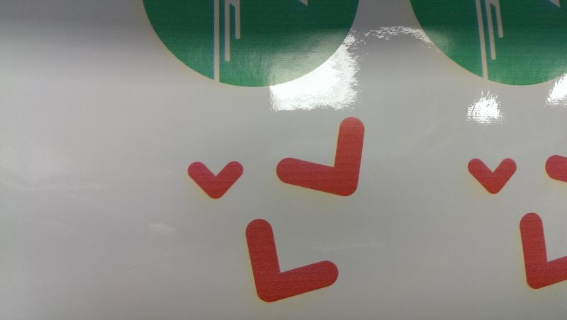

Hi my printer is have an issues with color.
we are getting a light yellow hue around the the colors (see attached pic) IMAG0814.jpg
if some one could point me in the the right direction on what maybe causing this,

Align your printheads (located in the Ink Menu).
You also seem to have nozzle performance issues as I see banding in the print. Run a nozzle test print (Ink Menu > Image Quality Maintenance > Clean printheads > Test Print). Based on that run cleanings for the affected head(s).
JoeBoomer
+1 for head alignment. That is yellow overspray typically caused from heads not being aligned. If that doesn't work, you may need to change the yellow printhead all together.

YAY! it worked
:rock-n-roll: awesome thanks we tried it and it worked did aligmnet and changed out the yellow worked great
