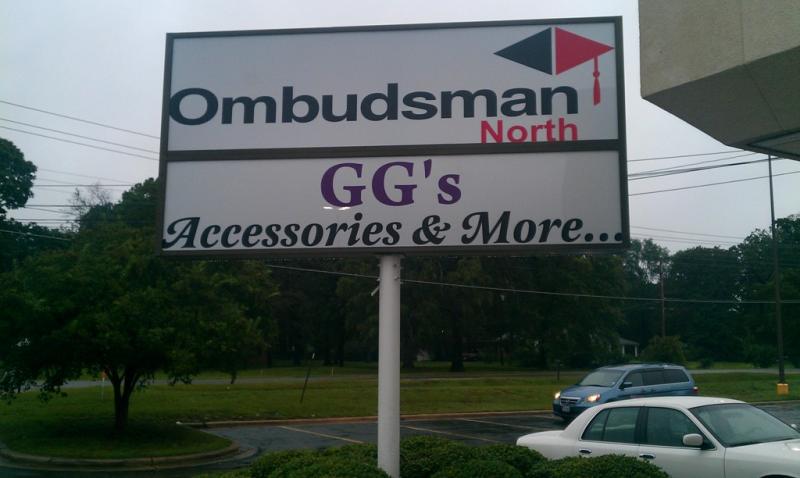

And, like Gino - ALL of our prints have always been Oracal Translucent vinyl.
