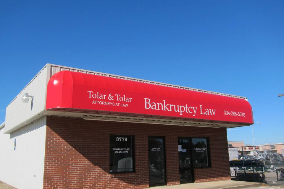

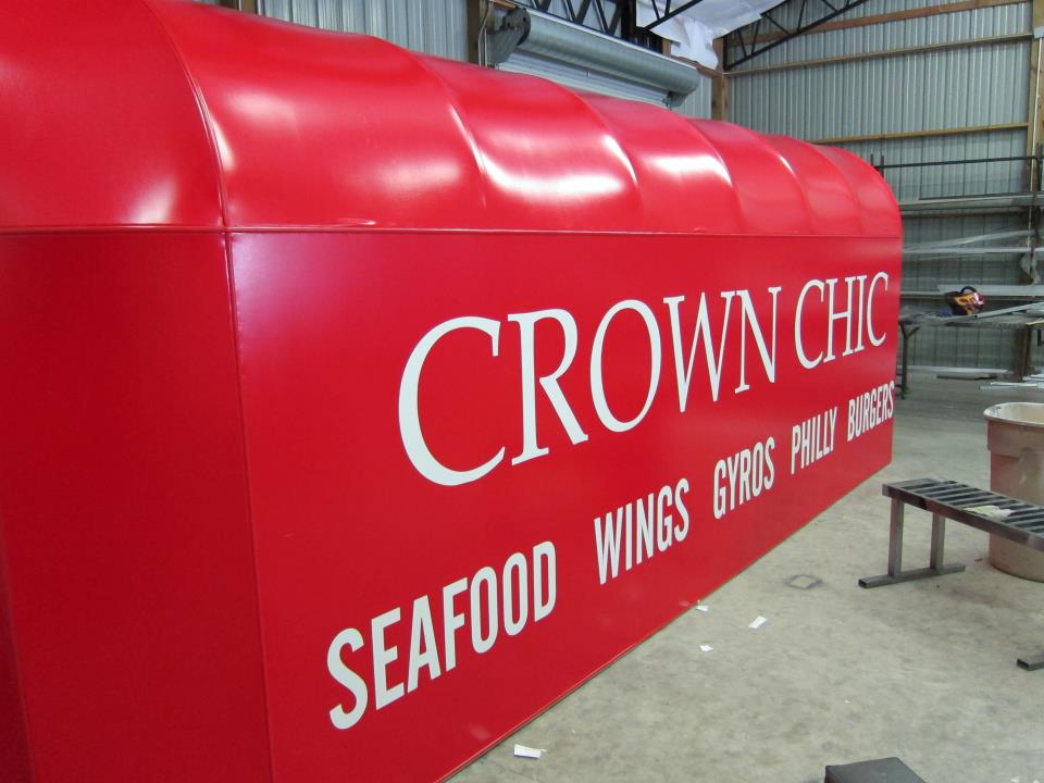

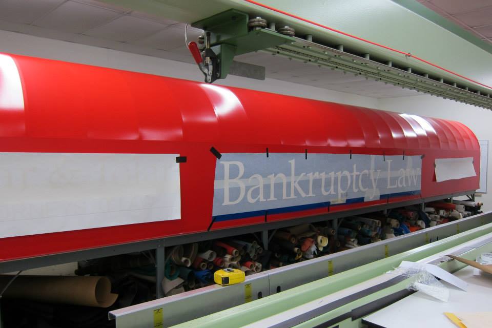

as mentioned on Sunbrella you have a choice of buying their graphics machine, to do this you will need a plotter or a close sign company. On backlit you can eradicate it, which I like. On vinyl you can place vinyl lettering and paint canvas if you wanted.
