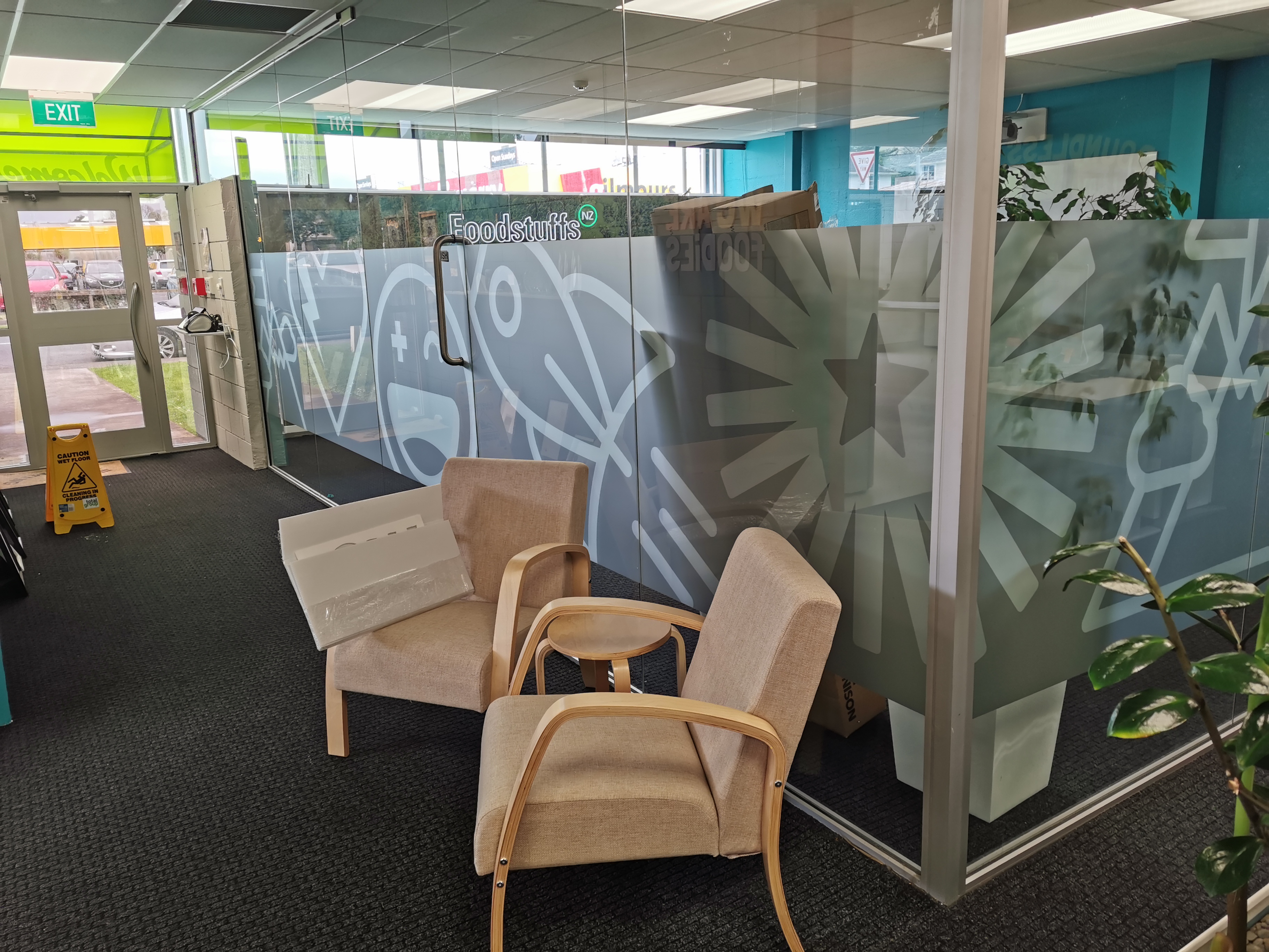

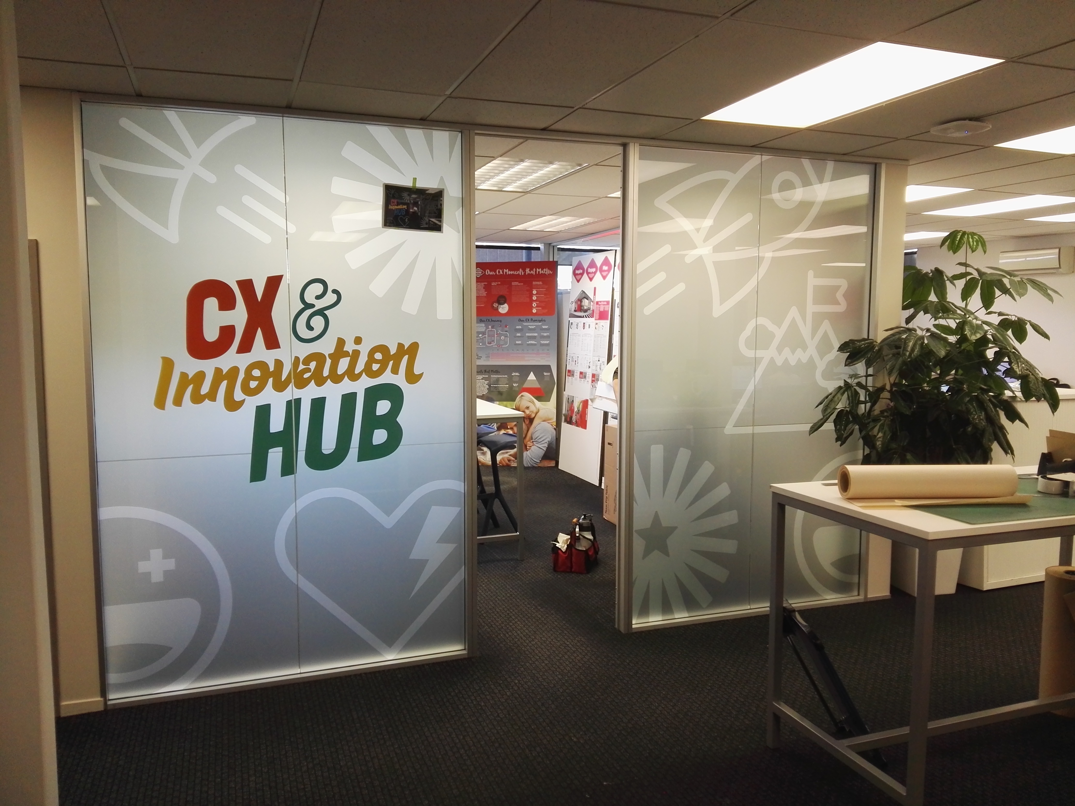

    We printed this on 3M 5525 haze using an HP 360, no laminate. it came out better than i expected it to, and the ink bonded really well.
