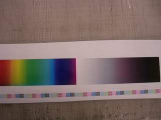

Now, our grey's are acting up again....This time, it is not red...its PURPLE to BLUEISH, just like the original poster... Someone mentioned that Cyan make have cross-contaminated into the Black? How would you know for sure, and what can you do to fix that? I am attaching a photo that has a Nozzle Test and a print of the rainbow, as well as a grey scale block..... What do you guys/ladies think? Please help! Thanks for your input.

Not a very clear image of the nozzle check, but it doesnt look like cross contamination from here.
That does really go back to color management - profiles and rendering intent.
