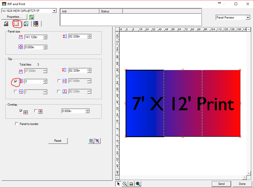

Are you paneling/tiling your prints manually or using the RIP to do so? We use the RIP to do it and have never had any issues. You may have missed one setting in your RIP however, even tiling. Are you udjusting for panel overlap as well? Picture below.
EDIT: If your panels are coming out different lengths (which i just re-read your post) you may need to do an output size compensation - for the media you are using.
