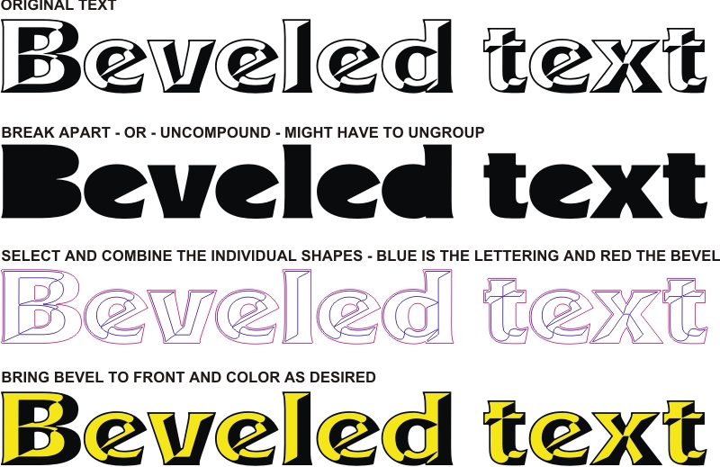

I use corel but maybe this will help.
I messed up, the red is the text and the blue is the bevel.
