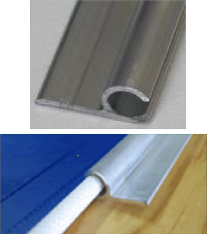

Sailtrack is an aluminium extrusion that costs pittance that a hemmed banner with either rope or kedar edge is slid into and along. We have several banners up around Sydney that we change every month or two..some 40' x 6'.
Most banners and a lot of billboards are installed this way over here.
