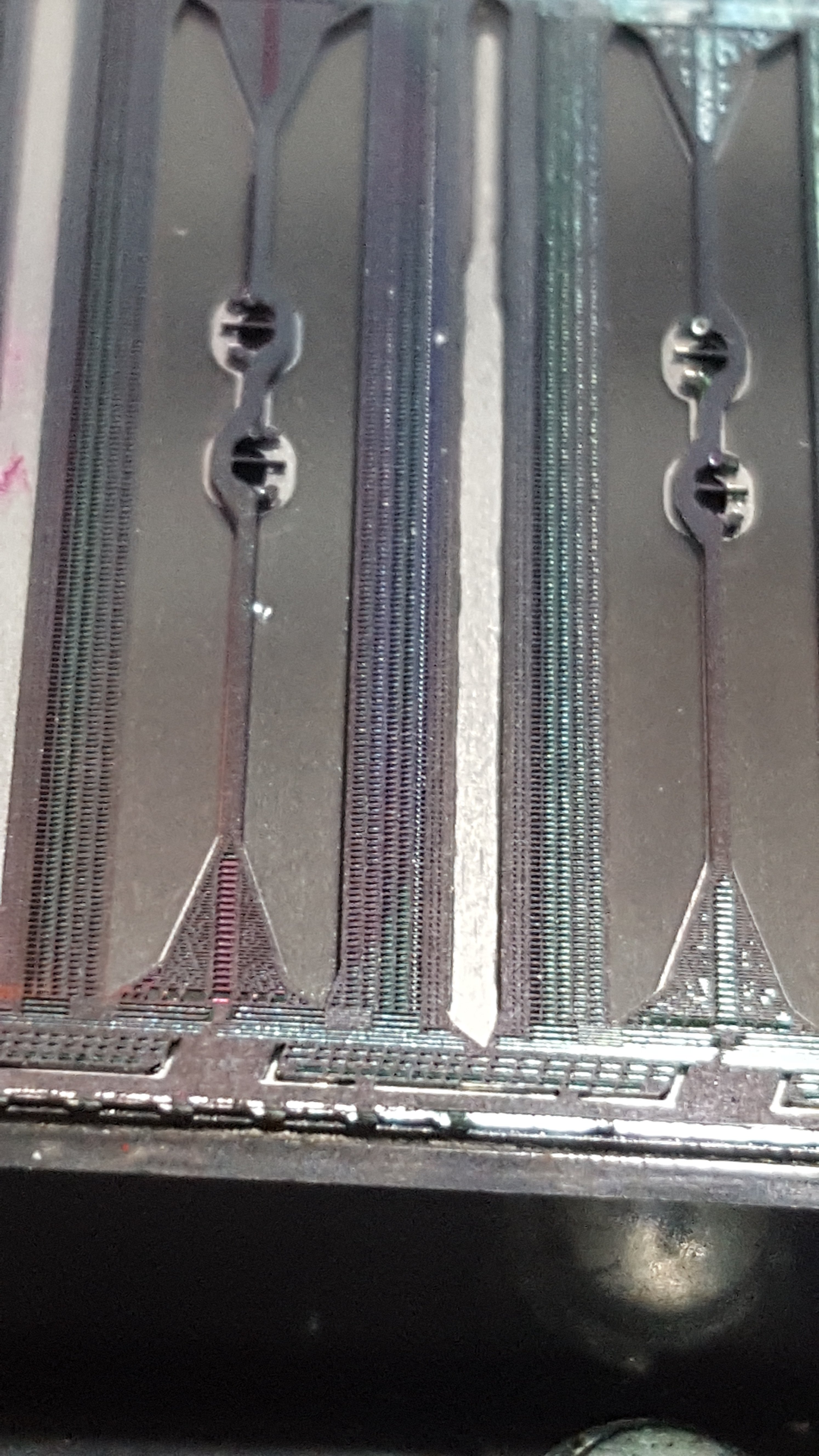

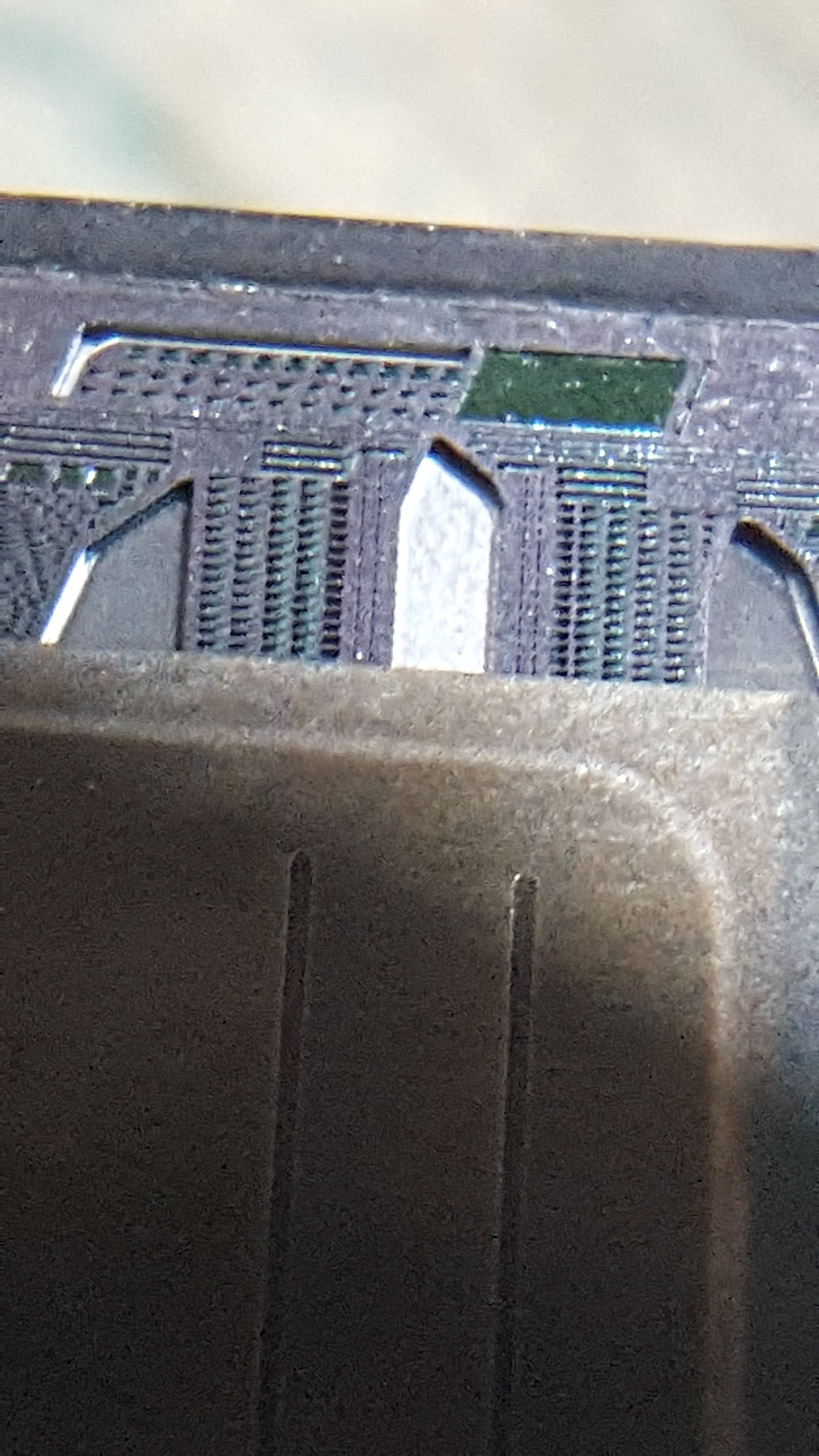

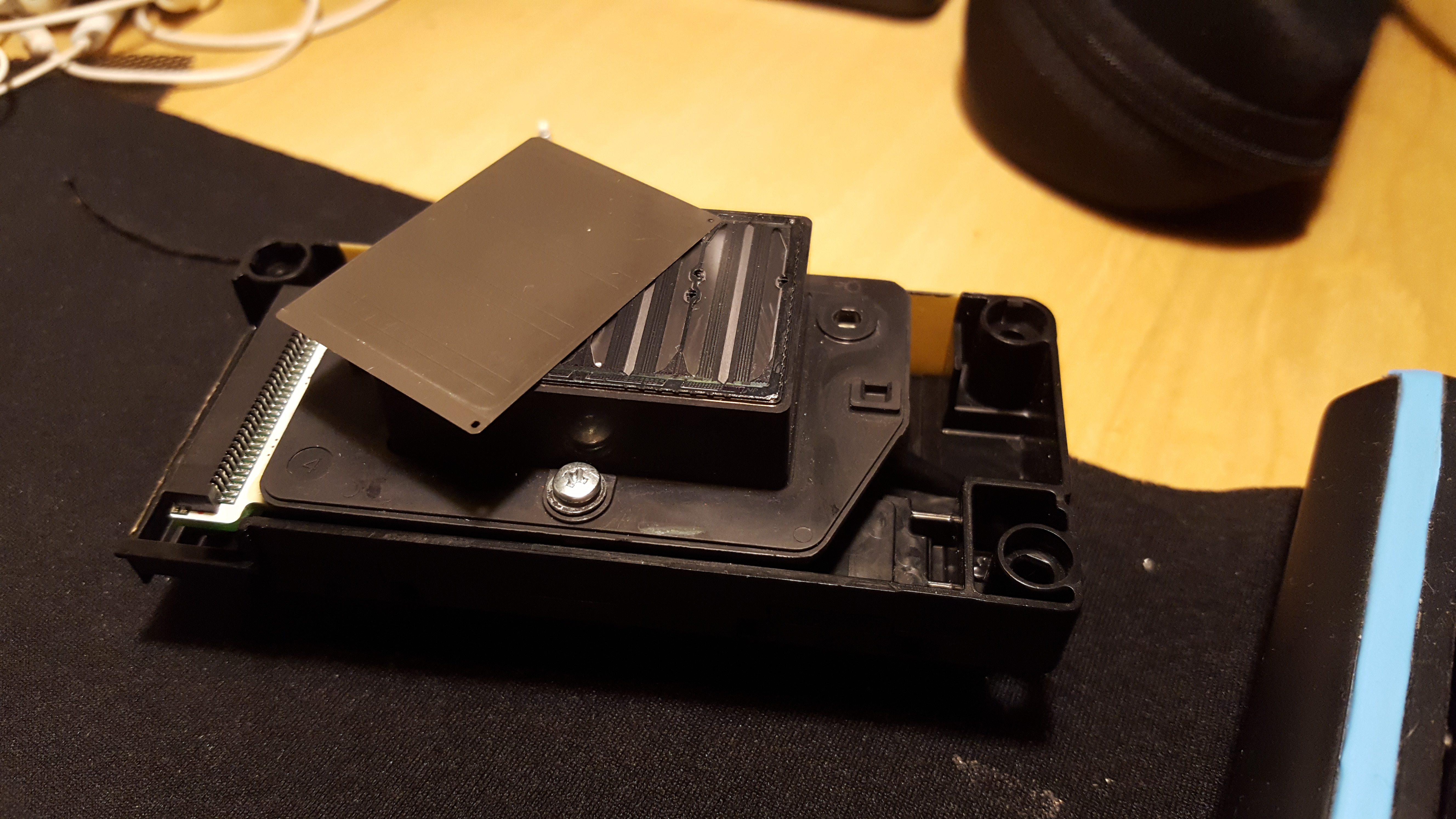

This is DX7 chinesse delaminated head

On the other hand, the heads in good electrical condition are repairable because, as I already said, the problem is that the external layer with the micro-holes separates from the internal one and loses tightness, thus creating a pressure that is not capable of being moved by the pizoelectric actuator of the nozzle
