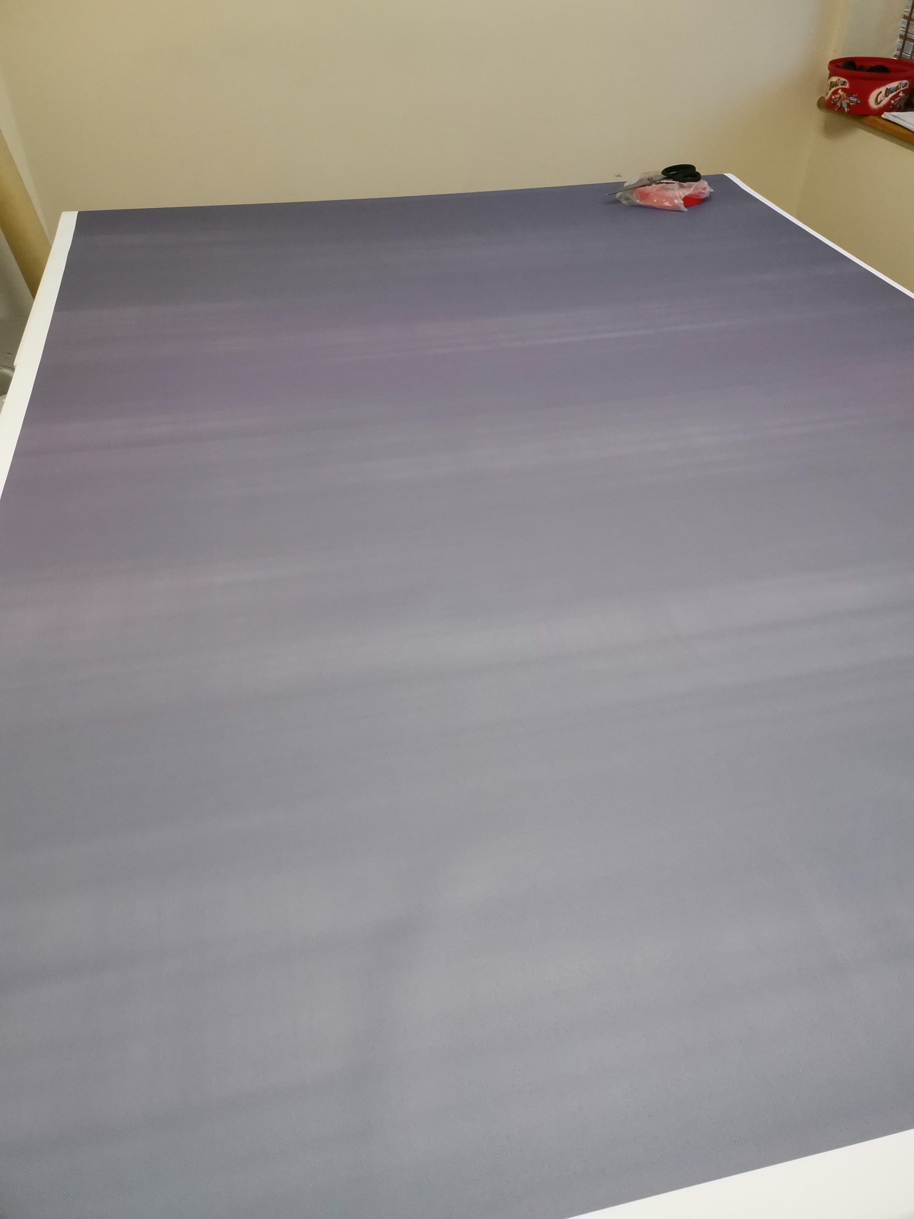

    Hi everyone hop you can help me.
    When I print a solid colour on canvas I get this wierd random line issue.
    Did a head check which was fine. Printing banner out perfectly on same setting as the canvas. Could it be the media causing the problem
    Anyone had this before?

    The print head movement also sounds slightly different than normal but have done all my normal checks. Seems quiter.

    Hello . I think the media is not printable, possibly due to poor storage or moisture. Try changing the media

    What is the canvas brand and type? Maybe a pic of the label...

    Hi guys thanks for the replys.
    It's from colorbyte. I have never had this problem before and have used 100s.
    Been stored behind the printer in its Usual packing box with wrapper. About 1 month old due to lockdown
    Thanks

    Have you tried raising or lowering your head height?

    Hi we always run the head on low. I have printed loads of other media since abd it's worked great so must be the canvas stock.

    Looks like low dot gain or pressure issue, The material may also not be printable, also if the canvas roll was laid down and had a flatspot this could be possible because of how uniform the defect is.

    I also print on a canvas using a flatbed and I've noticed these types of streaks or unusual banding. After turning off the vacuum, the prints became more solid.
