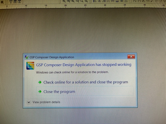

Having problem printing to a new HP Officejet Pro 9010e Series Desktop paper printer directly from inside my Gerber Omega 2.6 program. When I try Print or even Print Preview it locks up Gerber and shuts it down.
Gerber program is working fine and cutting on plotter from the program works fine, just not paper printing.
Printhead went out on my last HP Desktop printer 3 to 4yrs old and I bought a new HP and installed it.
It printed paper to the old HP fine from Gerber on it before. All I did was change out the printer.
I can print from any other program to the new HP printer fine. Just will not print from inside Gerber program.
Tried different new and saved files all same problem. I can export the file I am trying to print and it will print from the desktop just not inside Gerber.

netsol
You can try going to
Control panel>system and security>administrative tools>event viewer
Be very patient and wait till it finishes reading data...
See if anything is written for gerber omega, possibly under application
If there is, you can try googling it
Adam.Foster
Omega 2.6 was released 15 years ago and worked on Windows XP. Microsoft changed a lot of backend drivers and support files that Omega 2.6 and paper printers required. Newer paper printers are known to have issues with programs designed for windows xp due to the lack of legacy file support. Your best option would be to upgrade to Omega 7.0 on a supported version of Windows.

Might be cheaper to find a 15 year old printer still in the box than spend the $$$ on a new Omega upgrade.

Thanks for the information. I'll just export to my desktop & print from there. Don't want to change Omega since it's working fine other than paper printing.
