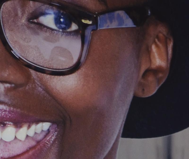

I think you may be seeing the dither pattern under magnification? I sort of see the same thing on glossy media but live with it as the option is to go with a color management system including a RIP other than VW. I find the quality acceptable.

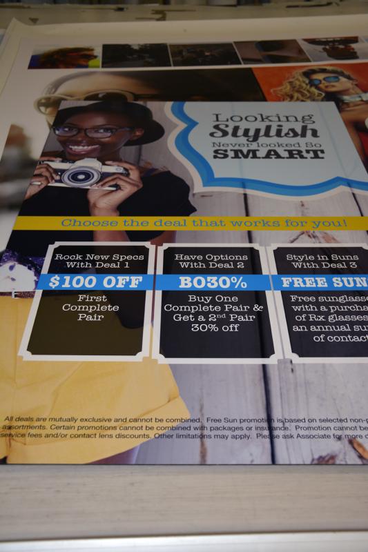

Attached are a couple of photos of a recent job on glossy calendared media, the overall poster is 24x36 and a closeup area to show dot pattern. Is what you are seeing similar?

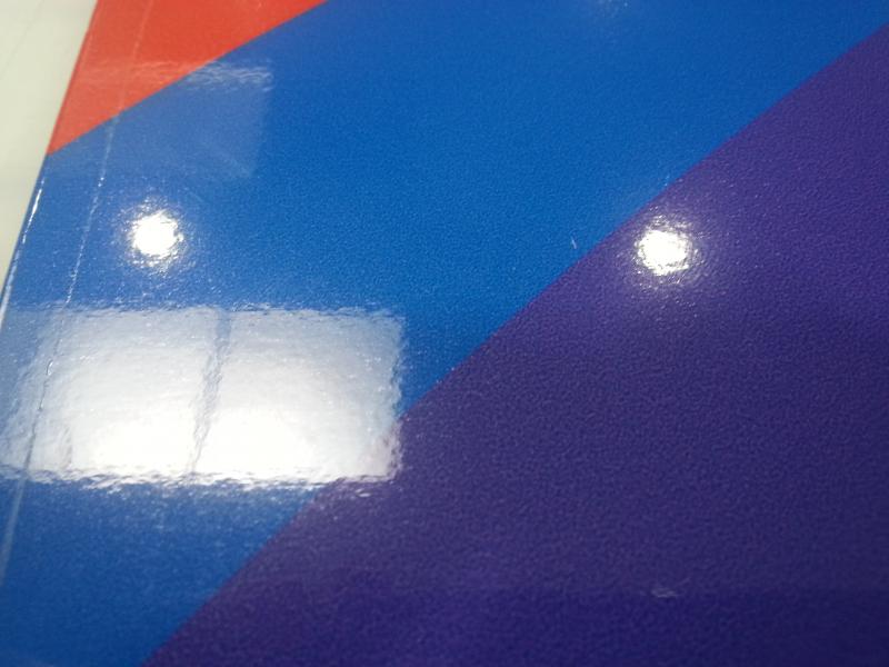

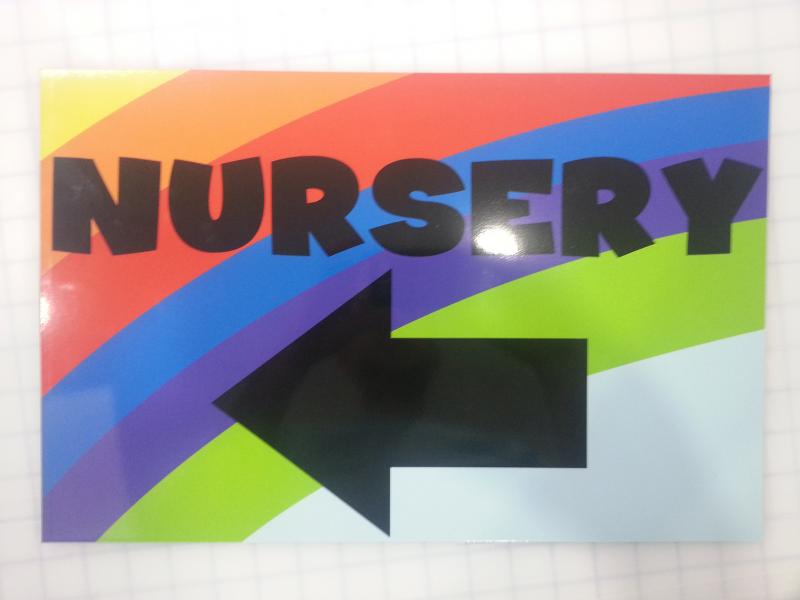

Its hard for me to tell from the image you've shown. Here is the best picture I could get illustrating the issue.

based on the picture posted, that is a typical output for an eco solvent print. No one is going to be inspecting the color from less than a few feet away. The minor amount of mottling there could be improved by creating your own profiles, but, that will never completely go away on a glossy vinyl.
