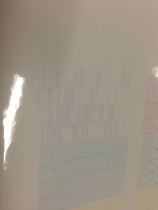

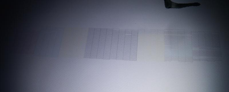

Hi,
You will find attached the test print, please help me to solve this problem.

Did you do a ink fill? If not, do couple of ink fills and do a test print again.
It helped me several times in the past.

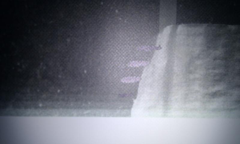

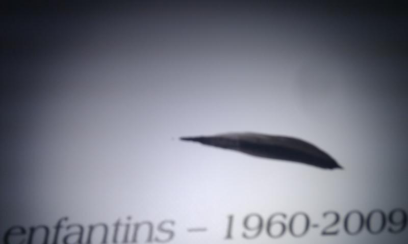

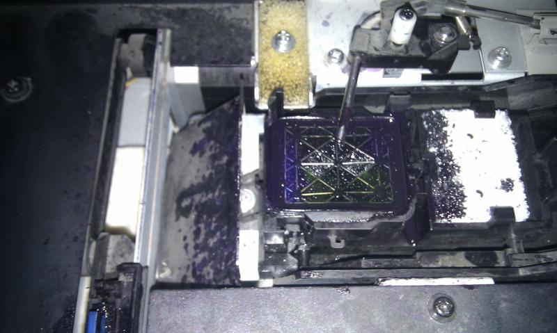

Hi Mustafa,
I'm going crazy, I start printing and here is the result, I think the problem comes from the clapping station, the cleaning liquid is not absorbed.

Have you pulled the print head over on maintenance area and look under neat the head?
There may be some lint build up and may be dragging on your media or there may be enough build up that may be dripping on the media as well.
How long ago have you changed your capping head?
If you did a nozzle wash and filled the capping station with cleaning liquid, the liquid stays in the capping station for a nozzle wash process.
Be more descriptive of the processes you have done so far, so I have a felling of what you have done to remedy the problem you are having.

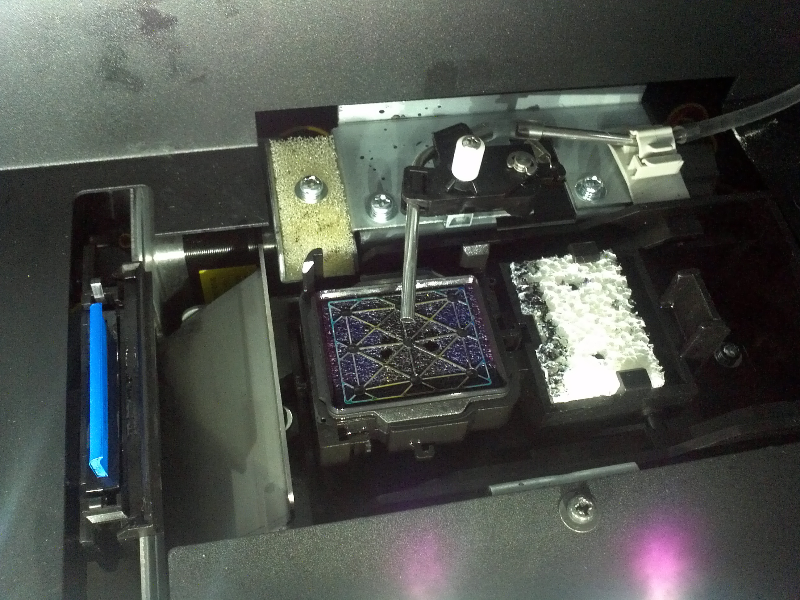

Here's mine for comparison... when is the last time you cleaned?

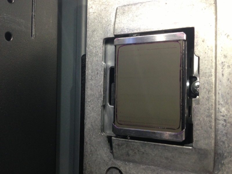

Hi,
I followed all the cleaning operations, nothing works, looking at the cleaning cartridge (Fill UP Solution), I note that the date has expired.

Although it is expired but it is still good, they don't go bad or stop functioning due to date issue. I know it from personal experience.
When you do a nozzle wash can you fill the capping station with cleaning solution?

Yea. I clean it daily tho
I clean mine daily as well but it doesn't look like yours.
In time you get ink splatters on the metal frame around the capping station and no matter what you do you won't be able remove them completely due to nature of solvent base ink.

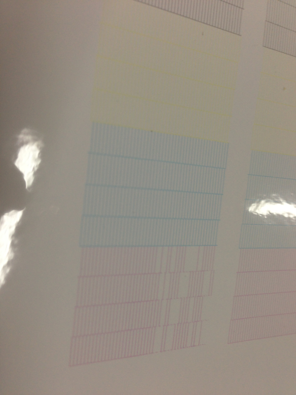

Hey guys, ill try that later, printing 100 pieces now. here is test print from yesterday, had to do a normal cleaning to be able to print. Also is a pic of the dx5

you need to know how to solve it? or try to? or you did solved it?
Attach cap top picture to check right sponge ink charge... or try taking it out...
also you may want to clean the sides of the printhead with some paper tissue(do it very carefully , but printhead are stronger and more resistant that people think) do not brush, just put the tissue and let it absorb.
but i think missing nozzles is because of drops in printhead..
