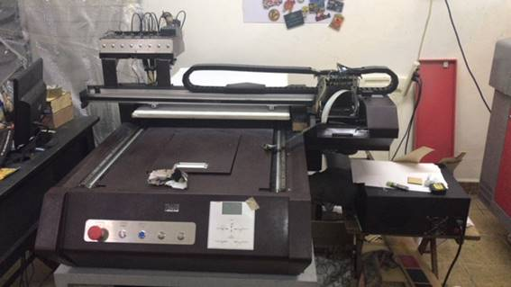

I bought from Longrun a Flatbed Uv printer, but unfortunately I have been a victim of a scam.
www.longrunuvscam.com
The printer they sent me was already outdated and faced many problems, for example the lamp controller never turned off and already 2 heads screw up because of that.

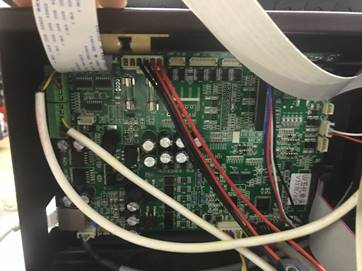

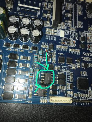

The printer is not working at all at this moment , I thought that one reason why the lamp controller was not working was because it was wrongly connected, and trying to fix it, the board burned out.

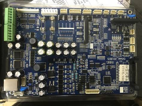

I count with another board that is supposed to be new, but this board is not compatible with the head and also burned the head, I would not know what may be happening.
What I need at this moment is to repair the mainboard and get a new lamp controller that is compatible with the board I have.

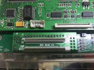

On the other hand I have the doubt of whether the new card that they sold me works with the head that they sold me that is blocking 2

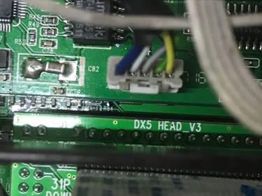

The new board is Head DX5 3v and the previous one is DX5 2v, I am not sure if it should use a DX5 3 blocked and the other one DX5 2 blocked

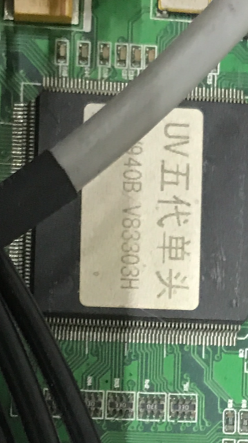

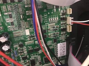

I add two photos with the names of the versions in the controllers.
The Board that I put below works fine but I do not count with a head and neither with LED driver and that is what I want to buy.
This card is the broken one, the component burned.
This is the head controller for this board.
V94B V83303H
