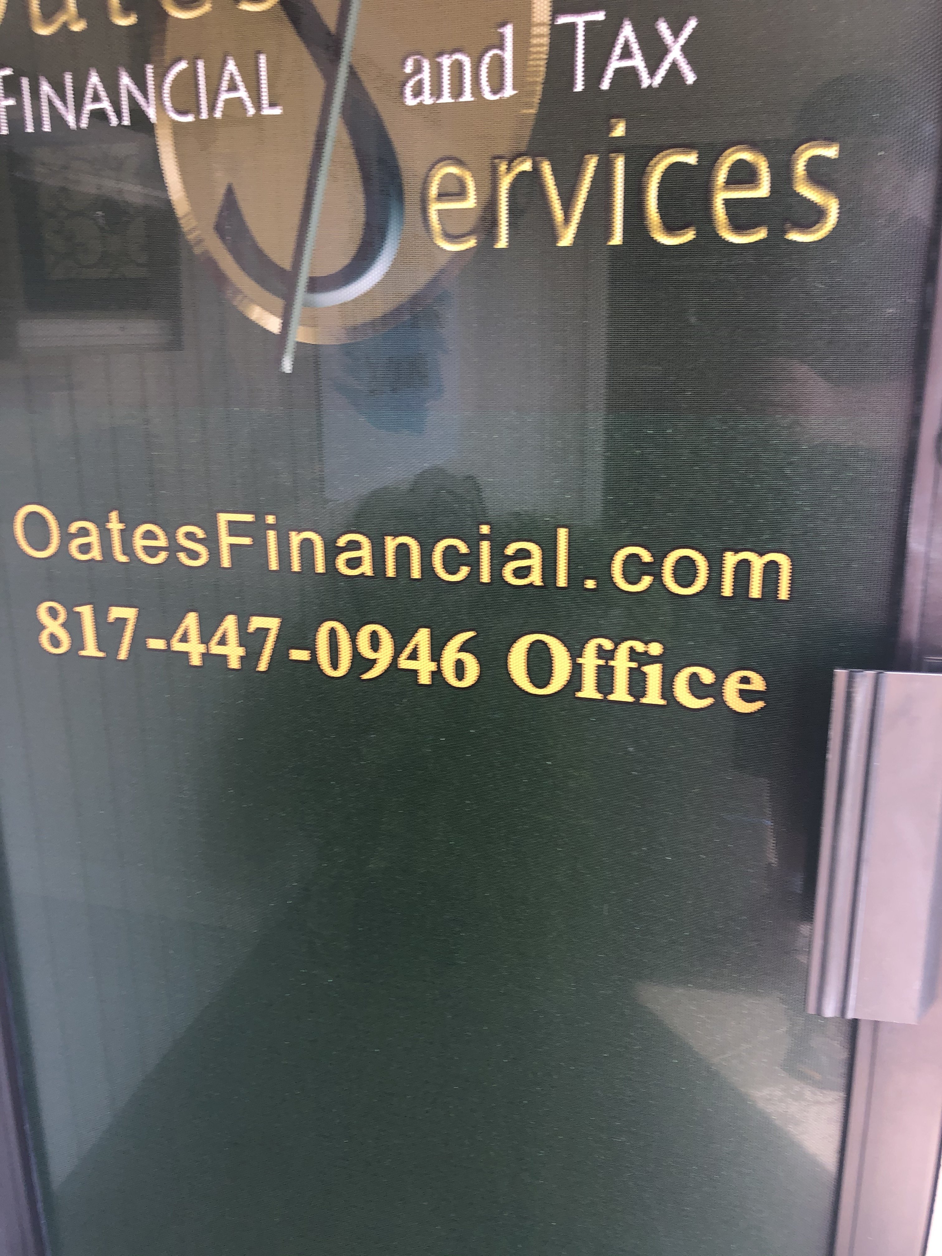

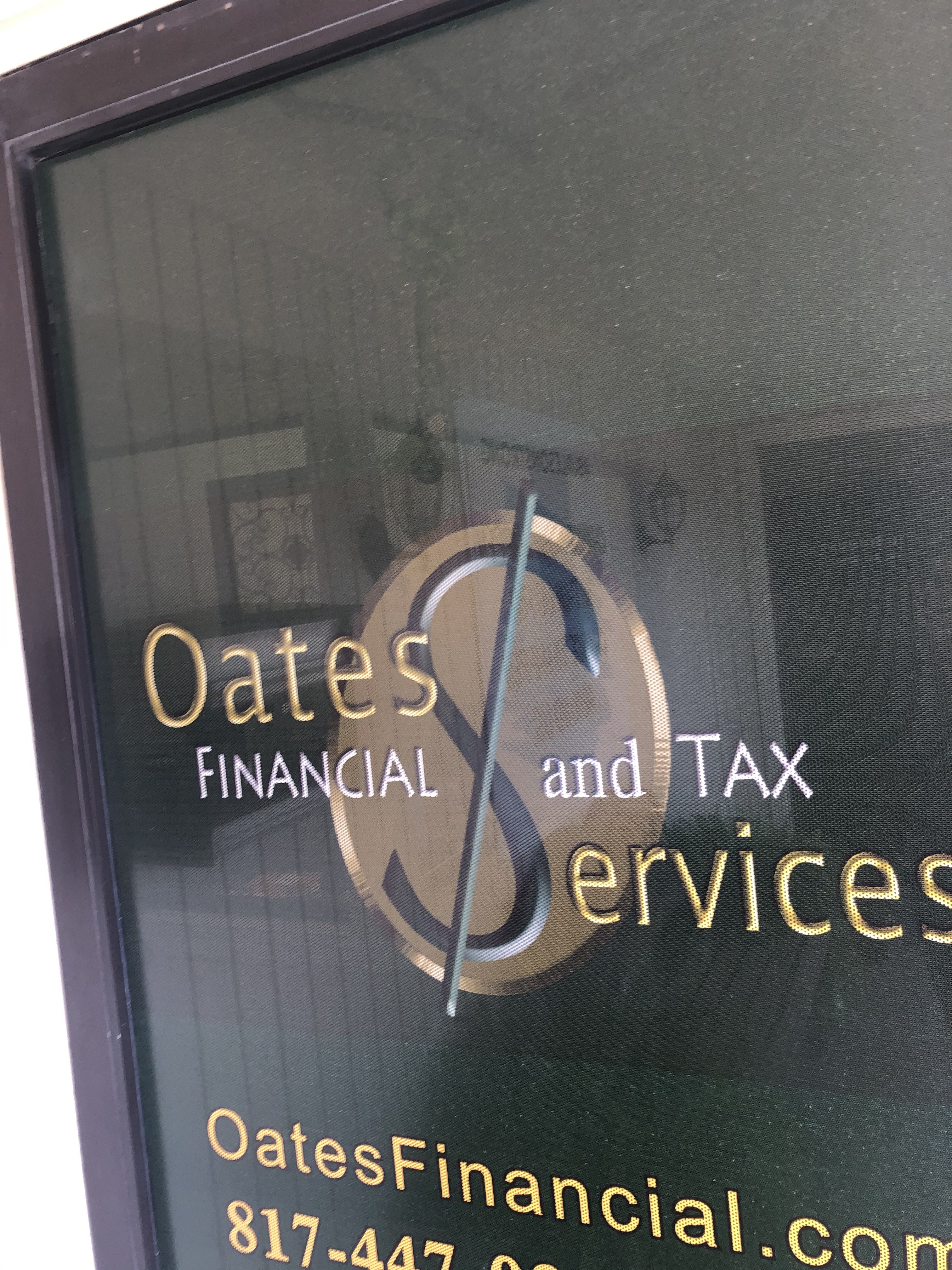

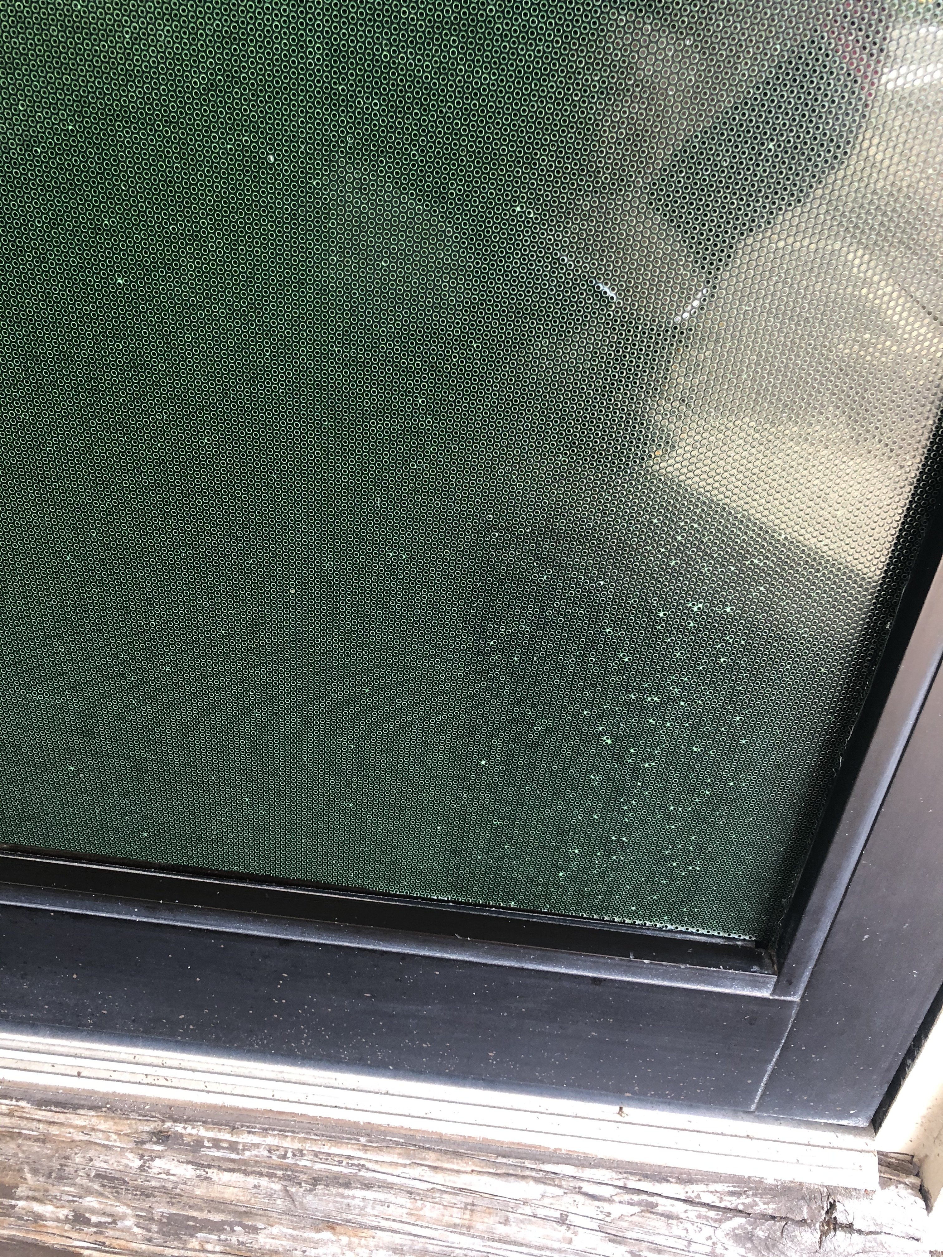

i double pass printed this, and used a felt squeege to apply.....ive never seen this, but it looks like dust, or like maybe the sqeege fell apart and the holes scraped the edge of the squeege....ive installed several dozen of these and never seen this....any ideas?
Maybe it's time to change the felt squeege !!
Looks like paint was scraped off, when installing these I never press hard on the squegee, in fact I barely touch it, it'll stick anyway.
2B
how did you prep the glass?
Looks like there was debris on the glass before install
we have taken to "scraping" glass with a wide edge razor.
even "lint-free" towels leave debris
