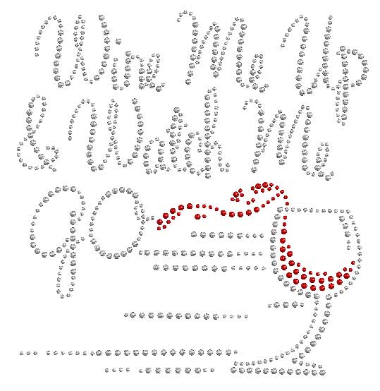

I guess these are not really sequins, nor rhinestones. The're like sequins but without the hole in the center. However, you were dead on. The directions read to do it at med pres, 345 for 8 - 10 sec peel cold. I tried again at 345, hvy press, for 14 sec and peeled hot/warm, and it came off much better. I dont know why I followed directions... I dont any other time.
Although these look like sequins.
I'm only used to sequins that you either sew by hand or sew by machine, so I'm used to seeing a hole in the center, but I don't see why it wouldn't be possible for them to be without one.
