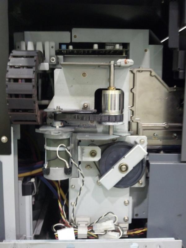

Just for grins and giggles, take the side cover off on the capping side of the machine. Should be secured using 4 Philips head #2 screws. Print an IQ print and watch the 2 rubber and the stainless carriage belt. Watch for possible slippage or sometimes on the stainless belt, a loss condition. I have attached a picture of what you will be looking at. I have seen the teeth on the rubber belts wear out and the stainless belt actually jump as the carriage reverses direction.

Thanks for the idea Danno, but after reading here i checked like you instructed and the belts are working just fine.
I cant understand this problem, when it cleans or something like that, it does the cleaning normally, its just when it prints (even the test print fails), and always after the second pass. One of the Techs even took the main motherboard and the heads motherboard and tested then on other machine with no problems.
