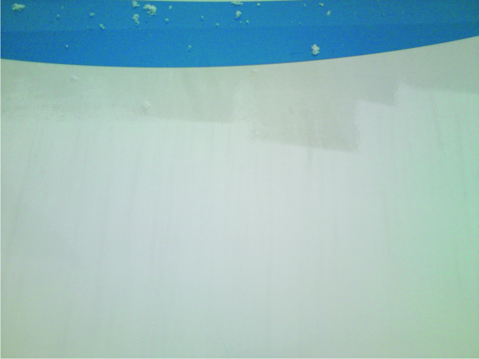

Ango
Looks like lamination on a vehicle ..
Ango
On this picture you can see a little snow, not to be confused ... lamination is gray.

The liquid laminate is flaking off.
And I see pressure washer marks.
