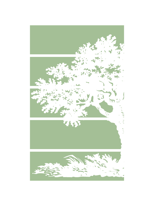

    Generally, when I have to tile something, I make my own tiles and send them to the plotter as their own file.

    Yup, I do that too. But this is for a lighted sign so it has to be spot-on.
    Just hoping there is a setting in the gaplot box I can try out!

    I just ended up doing as Rhino suggested, tried to be as exact as possible.
