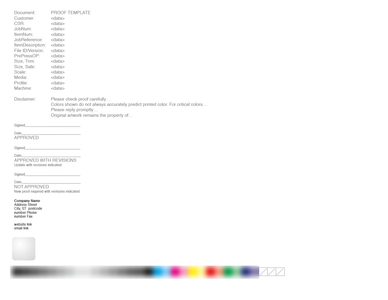

How much information to include? Does anyone else include information about all the colors in the files on proof?
Food for thought. Not a layout, just a list.
Yes, there is a place for important colors and their callouts.
