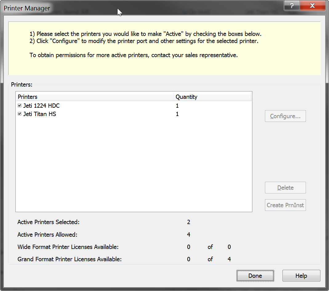

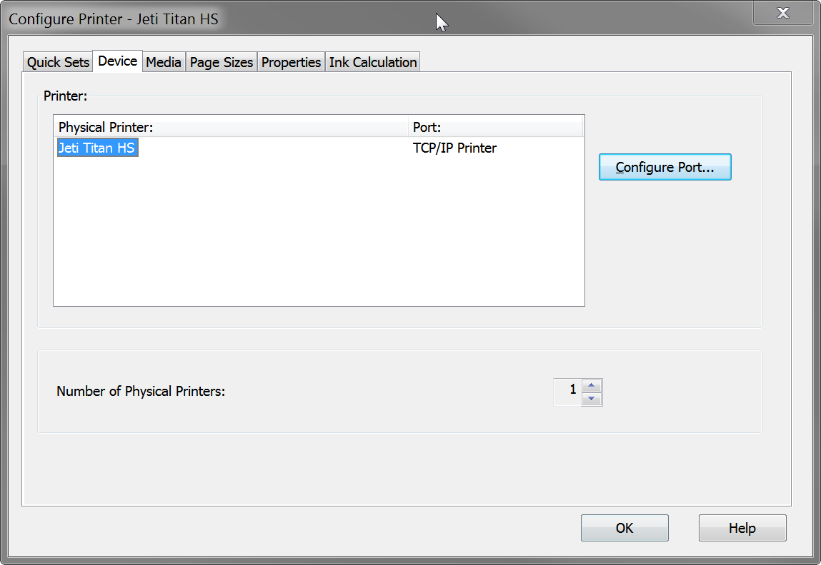

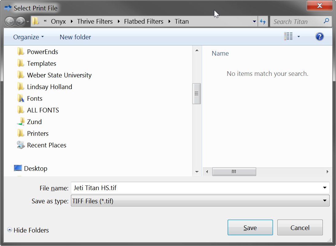

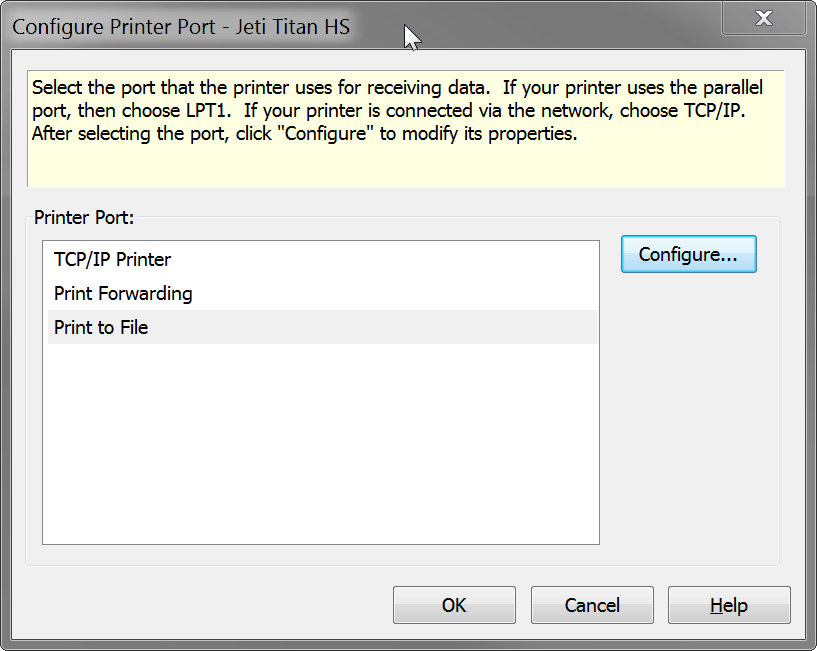

I think what you're looking for is called Soft Proofing. I don't think Onyx is really ever been great at this. You can essentially print to a .tif file rather than the printer itself and that should spit out what you want.
