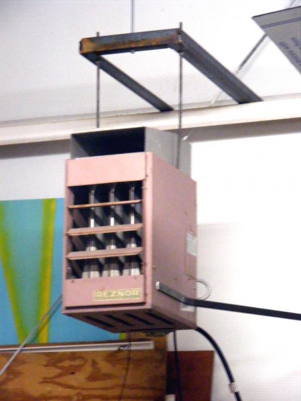

this is my shop heater. 30, 000 BTU REZNOR. shop is 24 X 30 X 16' tall. when its high 30's 40's it bring shop to 65-68 in a short time on a propane bottle, 20 pounder. it can get me a thru about 4-5 days befoe i need to refill for $15.00.
