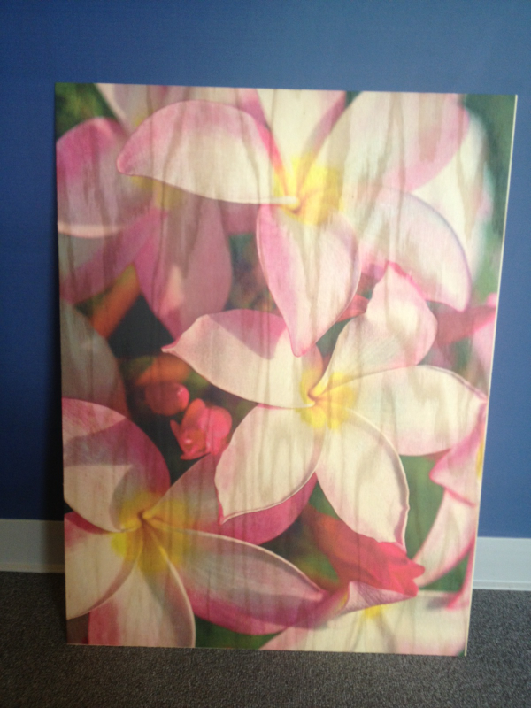

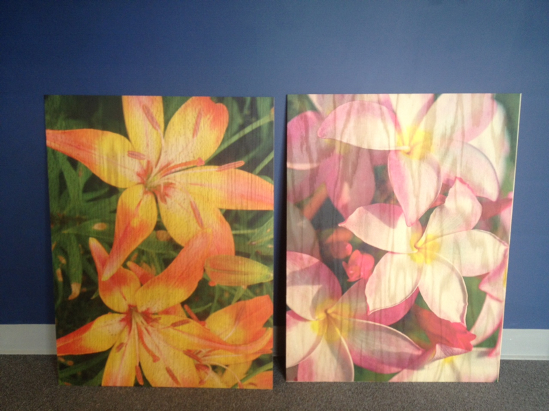

We've been experimenting a lot with flatbed printing to plywood lately and the results are really cool, that may be an option for you here. I would think with a few coats of some sort of polyurethane a sandwich sign like this would be durable enough, as long as everybody has a realistic understanding that it's plywood...
Attached are a couple flower images we just ran as a test, kinda gives you an idea how it prints on wood. These were crappy home depot plywood scraps too, we've done some others on higher grade material that looks a little less grainy.
