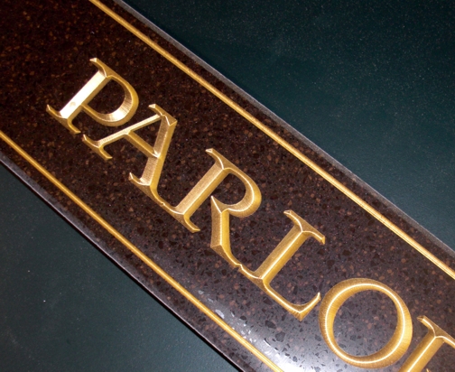

    Check out "Performance Signage", they are a wholesaler of corian signs! They might have some good info for ya! If I remember correctly the whole price was like $90 a sq/ft.
