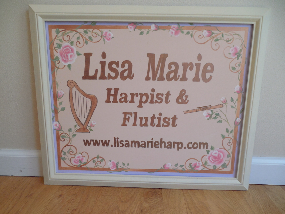

Gino - thanks - exactly the kind of info I need. On past wood signs, I used 2 coats of Zinsser 123 latex primer, a latex base coat on top of that in the color I want for the background and acrylics (occassional use of a Sharpie) for the art and lettering. Then I put on a protective finish coat - type depending on where the sign will be placed. This is an example - this was for indoors:
If I can get a good primer bond to the sign blank, the paints on top of the primer should be fine as long as compatible to the primer.

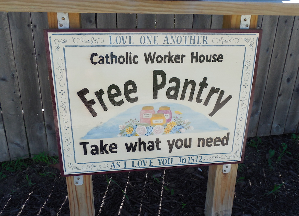

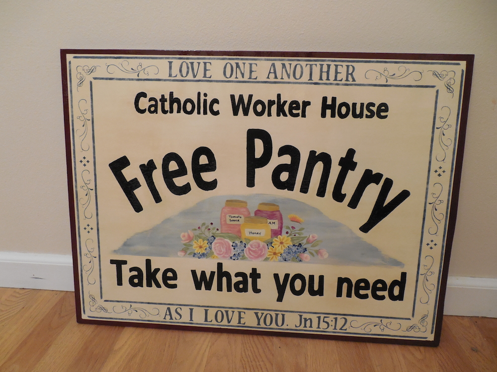

Thank you - I will look into those products. Fading is something I want to watch out for and learn more about. The original two exterior signs - which I did for free - still look fine. One is 2 years old but on a covered porch. The other is right on the street and in the sun and the full force of Iowa weather and in the sun a good part of the day. I pass it frequently - it is a year old and looks good - used a spar marine varnish which dulled the colors - I knew that would happen, but best protection I could find.(pics below) I told the person I made them for I was not a pro and would replace them if they did not hold up. I stopped by and looked at it today - a small chip in the finish, possibly due to last week's hail storm or when the little pantry was vandalized a few months ago. As I learn more, I will be able to replace with better if needed.
New:
Almost a year later - pic shows some fading of the roses - not sure if that is the lighting as I did not notice it at the time, just in the pic. I did not spend a lot of $ on it because of the possibility of vandalism in the area.
The sign I am working on now is for a friend - and I have said I will replace if it fails - and I am hardly charging her anything to paint it. It will be outside, but in almost full time shade. I know they seem "homemade" to a professional, but it is the look both places were going for:)
