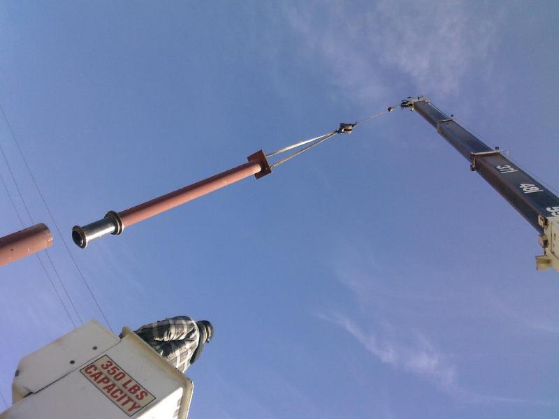

By the way....here is our pole going together on that job. Off the top of my head, I believe the cabinet was 6 x 24. I eye'd up the plate to the side of the building, and oversized the plate holes slightly to allow for a little twist.....Its lined up perfectly parallel to the building. Our hole had a footprint of 4' x 7' & 8' deep.

Same job? Did you paint the post black after the install? :Oops:
Wow....why yes I did Colorado. Why is it you ask?
Do you think it should have been painted prior to install? Prior to welding all the plug holes and plates, then grinding them smooth?
don't embarrass yourself any further Colorado.

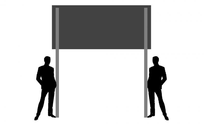

My 2 pics vs 10? You're correct, I don't have to prove myself. I think I allready told Keith that very thing. Most of my posts were in response to him. If you feel the best way to mark your holes on a 40" x 108" sign....that is allready attached to 10' 4x4 posts, is to stand it up...... well, have at it.
At some point one man will have to hold this structure by himself, while the other marks the holes. Sounds like a great way to damage your sign face when the one man loses it.
(the attached is to scale with the original posters measurements and 2 guys that are 5' 10" tall)
What amazes me is, Keith said he stands up the panel only to mark, then attaches to the posts......yet he is defending Colorado's way to do it as the proper way.

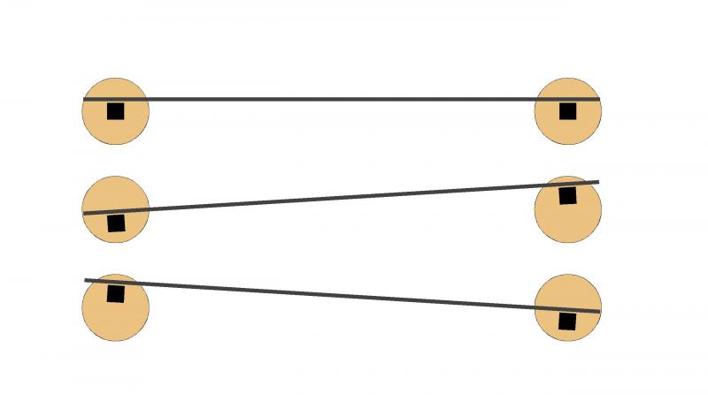

Now lets talk about "turn". See attached again.... Here is TO SCALE, the sign the original poster is talking about. The basic diagram shows very small 14" diameter holes. Novato, as long as your semi-close to being aligned, you will be fine. I usually lay a 2x4x8 on the ground and give it an eyeball. Most of the time, that will be fine. Per my diagram, you can "fine tune" the angle after its in the holes, and unable to fall over & get damaged. (if you want to get real percise, I can give you the Pythagorean theorem to get a perfect right angel to the road.)
You are correct....I have spent too much time in this thread. Alas, its only a 40" x 108" sign. I'm sure any way you want to do it will be fine. Some ways will take 1 man....some will take 2. Some will spend twice the amount of time installing as others, but hey....its not rocket science. At the end of the day we all will have the sign installed.
Navato, it all depends on the sign face itself whether or not I install attached to the posts. If not attached, I will install both poles connected & spaced with stringers. That way you will not get one twisted, and it makes leveling a breeze. Anyway is fine.....just don't install each pole separetely.
