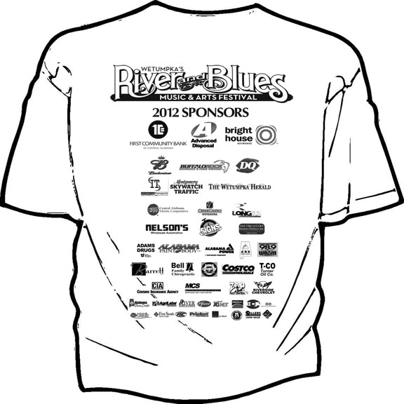

The festival is free so they couldn't offer free passes as an incentive to sponsors. Part of the deal with the sponsors was that everybody got their logo on the shirt, anybody over $250 got that and their logo on banners.
I guessed at 50...there are only 46. This is the working file of the shirt, not the b/w, it's what I've got at the shop.

That doesn't look as jam packed as I thought. nice job laying it out. Are they one color? A grayscale image would be nice, then it could be halftoned and still give some different looks to the logos.

Its the fades.....They need to be set as a PMS color for the post script printers that print velum to turn them into half tone dot.....at least thats how mine work.......

A good quality jpeg should be good if its single color and already scaled to size. the gray will have to be halftoned out.
Customers come in all the time with crappy jpegs that they want me to use and i make it work with certain plugins in photochop. Thats a simple print if you print straight from photoshop without rip software.

Yeah do a halftone
We do shirts here too. we run into this all the time. I would just create a Bitmap halftone in Photoshop. looks like you have the resolution good enough to create a good halftone. just use like a 45 dpi, with a 22.5 angle, and use the elliptical dots. Do it all at 100% scale. you will end up with small enough file that you can email to them with no problems.
Eliminating halftones where possible will help too. Like small text, try and keep them at 100% black, etc.
This will not compare to a vector file imprint but with high enough res. and some of them logos being so small the deference will not be that noticeable.
the t-shirt Screen printer should be able to do this as well.
hope this helps, if not, shoot it over to me and ill take care of it.
