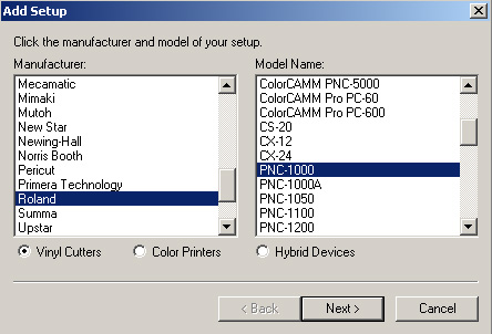

I tried but I'm new to the board and it won't let me send a Pm until I have made 10 posts! Anyway, I picked up An old Pnc-1000 and set it up on XP using the Centronics parallel cable. I'm using FlexiSign 7.0. I downloaded the driver from Rolanddg as well. Just trying to cut simple words and it will cut fine about 75% of the time. Then all of a sudden using the same file it will cut 6 of 7 letters fine and turn One of the letters 90 degrees or 180 degrees opposite of the rest of the letters in the same word or something crazy like that. I've played with all of the settings on the display but can't get anything consistent. The error I get is "error 2-wrong # of parameters". Any help is appreciated. David
Sign Works
Probably just want to do your set-up in Flexi for the cutter, Flexi should have the proper driver.

First off thanks a bunch to those who took the time to reply. Here's what I found. After removing the covers to look around a little I found a nick in the top off the rail that the carriage travels along. This nick was deep enough to momentarily catch the wheel which apparently let the coordinates get slightly off. Also there was a pretty good build up of "gunk" on the rail and in the wheels, A little sanding to smooth out the bump and rubbing alcohol to clean everything and I've been able to complete numerous cuts with NO errors. Really relieved. Maybe I'll get some sleep tonight. Thanks again.
