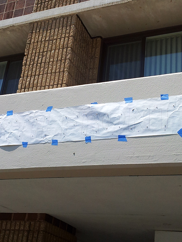

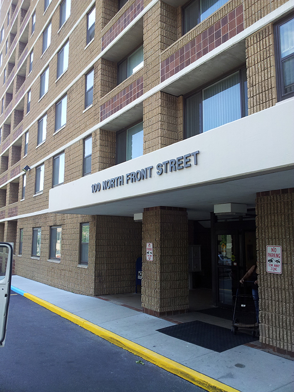

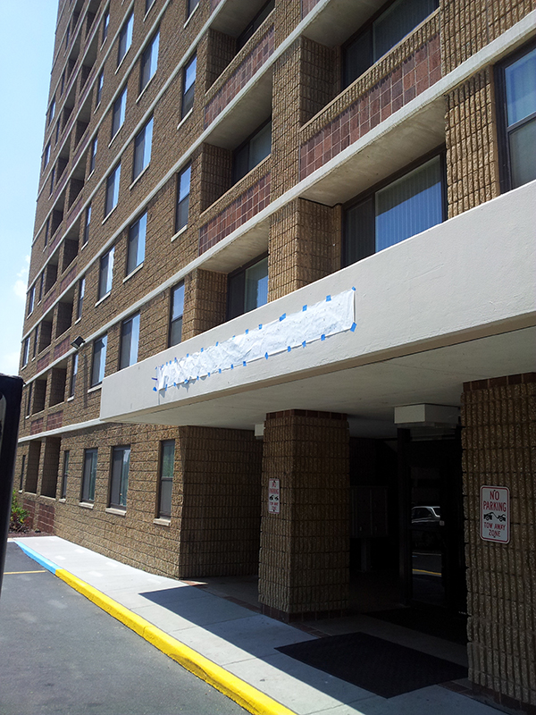

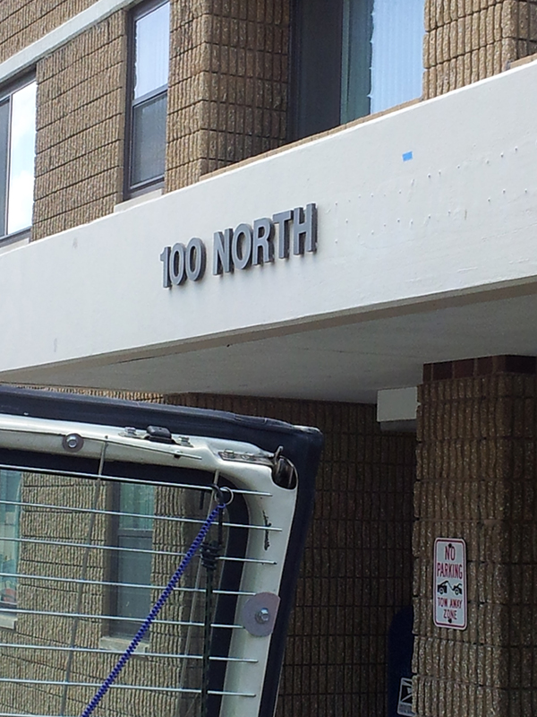

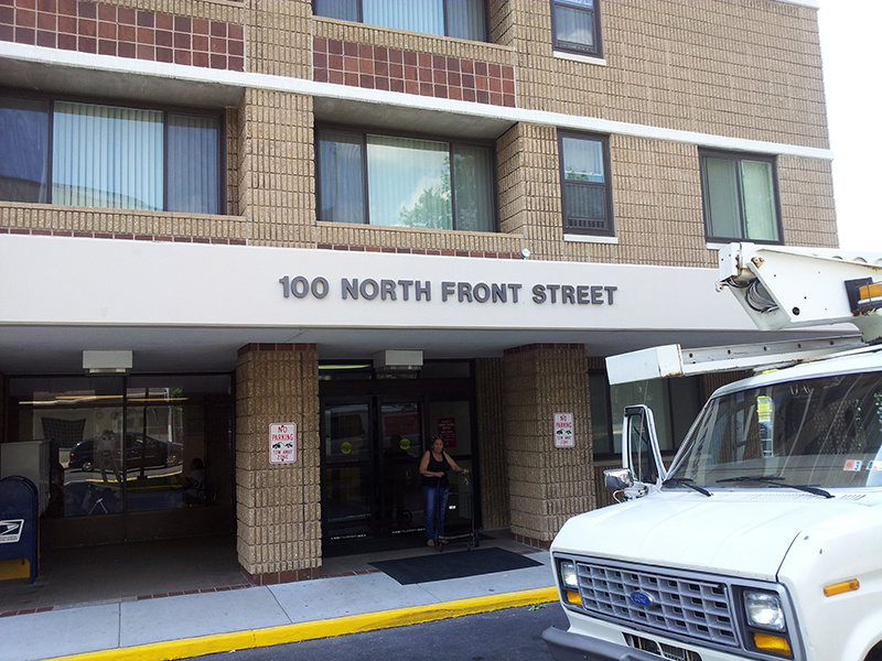

    This place was only about 15 minutes from the shop, but from the time I got there, talked to the people in charge, got their instructions as to where on the canopy the letters go, until I took my last picture, packed up and got paid, it took 2 hours and 15 minutes. Drilled out about 90 holes and used a combo pad and stud setup with 4" studs.
    Patterns was dead balls on, but their wall had been patched by someone who wasn't very good, which made some of the letters look a little odd. However, I pointed that out to them before I started and manged to make them look fairly decent. When they came out, they loved it and said,who cares if a letter is slightly twisted. I hafta agree, but I like making things known beforehand. pattern.jpg pattern closeup of holes.jpg some letters up.jpg finished.jpg finished dif angle.jpg

    Not many people will let ya work on something without knowing what it's gonna cost upfront. I got there at quarter of 12 and was leaving at 2. The hardest part was drilling those holes. The rest was easy. Went down and glued up 5 letters at a time and boomed them up, slid them on and that sh!t stuck within a few minutes. 1/2 a tube, and that was being generous.

    You mentioned twisted letters due to the wall.....It might not seem like it would make much of a difference, but the pattern looks really loose. The location of the holes can easily be 1/8" to 1/4" off if your pattern isn't tight.

    Actually, you're right, it wasn't 90..... it was 82 all total. Felt like 182. :p The pattern not being 100% tight had nothing to do with how lousy the canopy was patched. Hell, some holes didn't drill at all for whatever reason.... or all the way in, so I cut those studs off and relied on the pads and glue alone. The letters all worked out fine. Done enough of these things over the years to know how things work and 100% tight is nice, but not at all necessary. When you have a patch on a wall, that sticks out 1/4" on a slant, it's gonna skew with the adhesion or angle of the piece. Not my fault. :eek:
