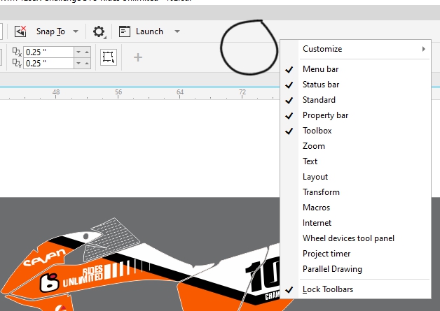

    We are trying to figure out how to add our quick launch icons to Corel 2020. We had them in our previous version. When we upgraded, they are not there. These icons allow us to print or cut straight from Corel.
    Thank You!
  2. unclebun
    unclebun Very Active Member
    Right click in the blank toolbar area (circled in photo) and make sure "Standard" is checked.
  3. hitking
    hitking New Member
    Thank You. Standard is checked. Quick Launch is there. It just doesn't show the icons for my printer.
  4. unclebun
    Go to Tools, Options, Customization. Choose Commands on the left column. Choose File in the dropdown box on the right pane. Find Print and select it. It should say "available on Menu Bar, Menu Bar, Standard." If it doesn't press Restore Defaults.
  5. unclebun
    You could also right click right on the Standard bar, Customize, Standard Bar and either reset to default of click add new command.
  6. hitking
    hitking New Member
    I will try both. Thank You!
