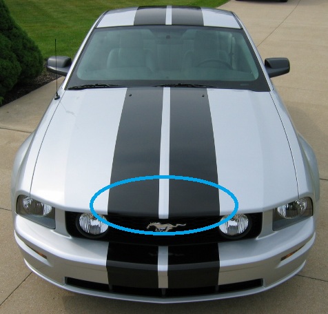

Have a customer interested in racing stripes like the picture provided. Question I have is where the circle is in the picture, from the hood being the most contour there, how do I keep the 1" gap between the two stripes parallel without running into each other or running the gap closer? Any tips appreciated

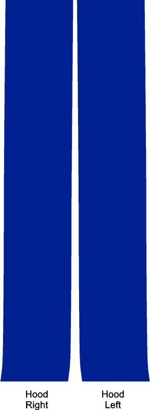

I have done some mustangs the same body style & I flaired the ends of the stripe out a little (maybe 1/4"or so), then made a mirror copy of it with the gap needed. I used some old scrap vinyl & cut some short stripes to fine tune the amount of flair that worked best. The hardest part is figureing out when to start the flair.
Check out the pic.

Thanks, thats what I was wondering. I didn't know if it was cut that way or just fine tuning the vinyl down towards the front of the hood. I'm sure it can be done by pulling the vinyl into place but I didnt want to distort the stripes

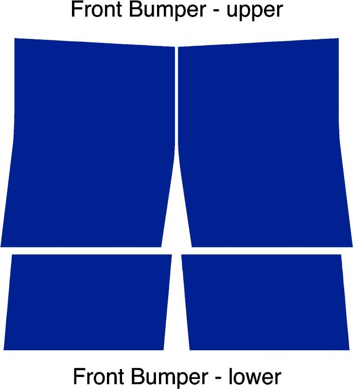

Hope this helps make life a little easier. The same also needs to be done on the bumper too. Another tip is to stick down some transfer tape on the bumper, then draw your stripe as straight as possible on the tape. Now remove it and you can see about how much you need to curve the stripe. The closer you can get it, the less you have to fight with it during installation.
