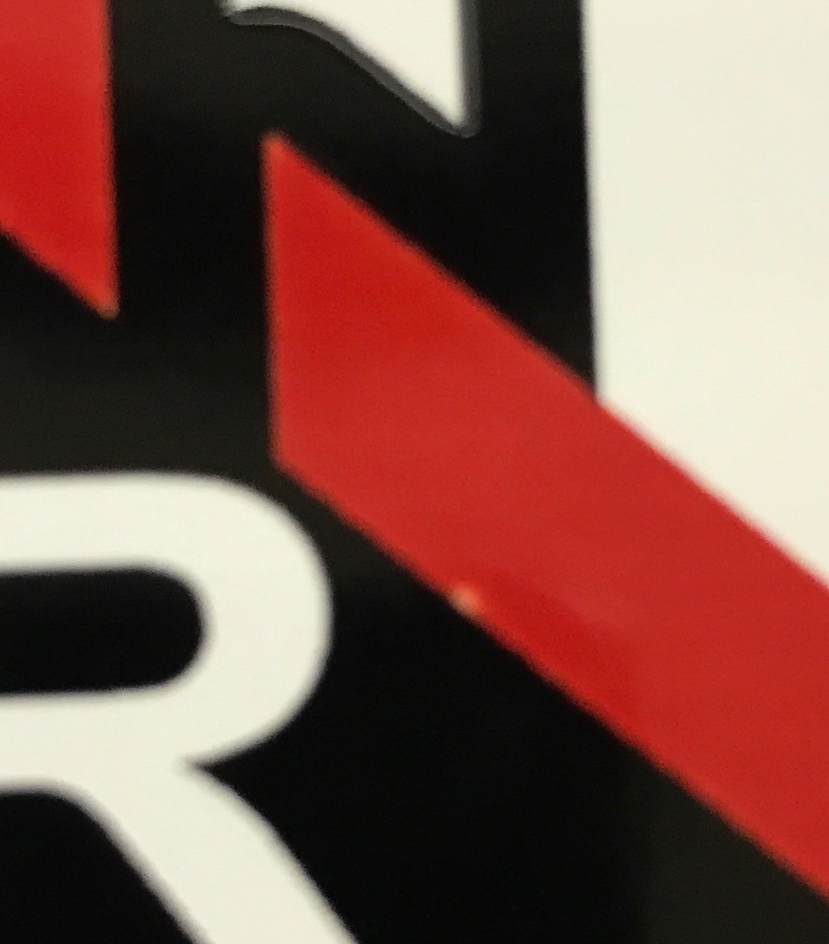

So I notice every so often that for some reason I get a white fish eye when printing red. Doesn't seem to happen on others colors. Or at least not enough that it is a concern. But happens enough when printing red that it does concern me since reprints are often required. It would seem the media may have some contamination if this did it on all colors but really only see it on red. Any reason why or is there a fix?
IsItFasst

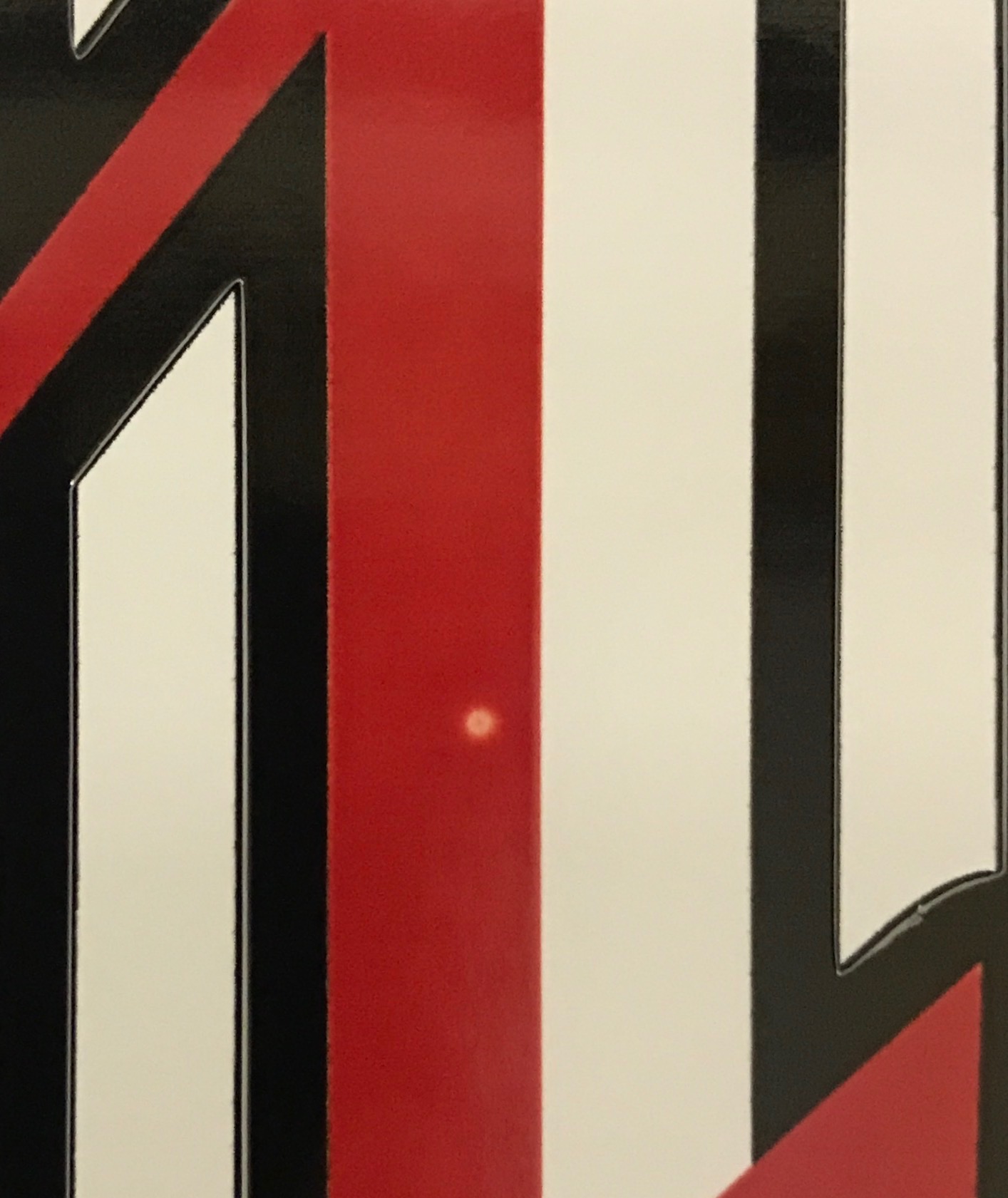

File Aug 29, 7 45 30 PM.jpeg File Aug 29, 7 45 43 PM.jpeg The first picture shows the issue. But in picture 2 you can see that even where the red and black meet up it only seems to happen on the red part. It's like if the black ink hits that contominated area (if that is the problem) it has no issue covering it up. FYI. This is Orajet 3164 but I think it has happened on several rolls and brands since it has been happening for months now.

Yeah, it's just so odd that it only happens on red because it looks like contamination of the roll but you would think it would do it on other colors if so or just on one particular roll.

I think you are over saturating the red. Looking at yout tiny pics one sharper image shows dark clouds in the red. You are printing way to much red on that material and it can't handle it. What material are you printing on? Try to use a different profile. Not sure what rip software you use. i had similar issue and i had to custom create a profile. Well. basically i just took an existing profile and lowered the total ink limit to like 200 from 220.
Try to see what is the total ink limit on the profile you were using. try to lover it. 200 should be enough for any print. I won't go lower than 180 total ink limit.
Andy D
Agreed! This is what happens when your ink limits are too high. Not only are you wasting ink but the ink is pooling away from contaminants before the ink has a chance to dry.
And yes, your ink limits can be too high for some colors and not others.

I'll certainly try these recommendations. But since it only happens with solid red and is so few and far between it may be a while before I can report back with any updates on what works or doesn't. I really don't want to do any dramatic changes since the colors print so great using this profile I tweaked. But limiting ink may help.

So I had a print to do with small red lines so thought I'd limit ink by 10% on this print just to see how it looked. All that did was cause my reds to be more "washed out" looking and oddly a small dot still appeared on the red.
