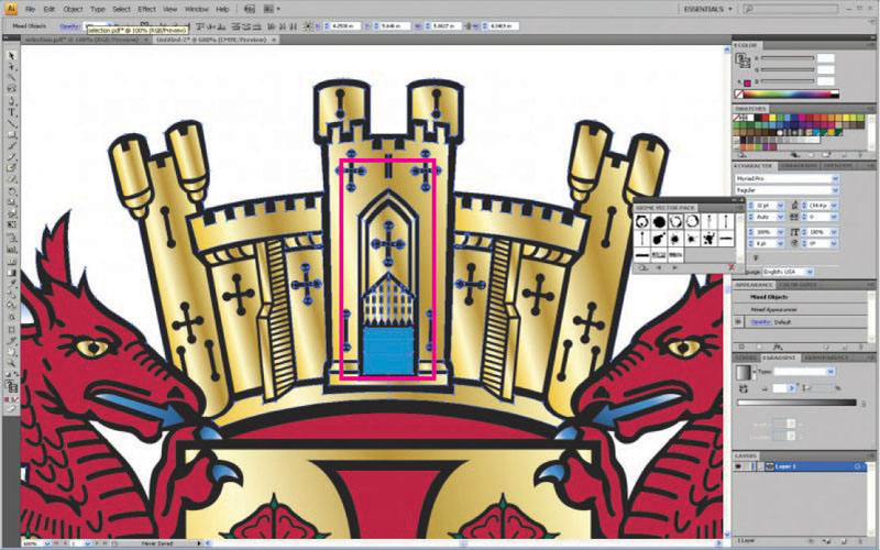

This would have been my selection path... open this file and try it....

Select how Rick, with the edge select on, dragging a box, clicking on each object? If you don't have the background locked, doesn't it include that too if you draw a box? If it's one by one clicking, I'll be clicking those flowers for hours. I think I don't understand how you're doing that successfully. I'm not trying to be difficult, and as I said at the start of this, I think it's user error (me!), and I just don't understand it.
How would you select the 30 or so pieces of each flower, being there are about 20 flowers all over this graphic?
I know what I'd do in real life, I'd lock the backgrounds and drag the box, and deselect the things I didn't want. That's how I have been doing it, but I just get the feeling I'm missing something far more simple.
Edge select on, stay INSIDE the box and make sure you touch each object inside the box... do not touch the background box
no, try the file I gave you...
That coat of arms file is jacked up, but it can be done by selecting by color or other ways....
