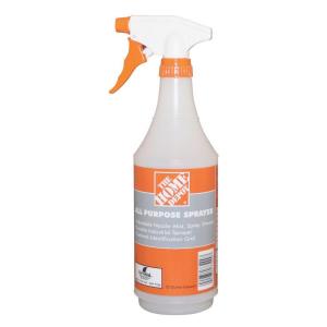

I purchased two 125oz bottles of Rapid Tac application fluid and purchased a 32oz spray bottle from Home Depot, their branded spray bottle which I have used for many different spray applications in the past without any problem.
After just a few pumps of the spray bottle with the Rapid Tac application fluid, the spray bottle stopped working, thinking something was wrong with that bottle, I tried another spray bottle, and had the same results.
Is there something in your Rapid Tac application fluid that attacks the inner workings of theses spray bottles, causing them to stop pumping?
It appears the spray handle does NOT return all the way, so it can be pumped again to draw fluid and spray.
Do I need a special chemical PROOF spray bottle to be able to use your Rapid Tac application fluid?
If so, what spray bottle do you recommend?
Anything I can purchase at a local retailer, like Lowe's, Walmart, etc?

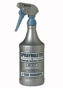

there's nothing abrasive about rapid tac. any bottle should do.
home depot spray bottles are... ok... but there are plenty of better options available.
they're nice, because they're inexpensive, but cheap is cheap.
spend a couple more bucks and get something more durable:
these are also available at Home Depot... and my personal favorite (even for abrasives, like isopropyl alcohol)
attachment.php
edited: I can also chip-in, that the bottle posted by ThinkRight is very good as well. Although, the pump-sprayer bottles are bulky and quite a bit more expensive. buuuuut they WILL last forever, if properly used/maintained.

I really like the handheld pump bottles for the range of chemicals that can be used, ZEP,paint thinner , insecticides....Never failed until I dropped the 5 year old one I had.

phototec
Hey everyone, thanks for the info.
I used two HD 32oz spray bottles yesterday with Rapid Tac, and both only worked for a few minutes before they quit working. The plunger under the pump handle would compress, but NOT return, like the Rapid Tac was swelling a rubber seal or something.
Anyway, they stopped pumping and would NO longer spray the Rapid Tac.
I will go by HD to get one of the other sprayers shown above and hopefully they will work.
Thanks guys, for the help!
