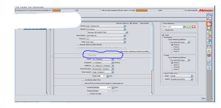

It's in the, "Quality" tab where you choose your profile. That way you can see the time difference between certain modes etc.

Here is a screen shot of where to look.

Rasterlink gives you estimated print time if you print ONLY but not when PRINT+CUT, try only printing something you'll find the estimation pretty easily somewhere (im not using rasterlink anymore)

Did you rip or print the file? Need to do one of those before it will show ink calculation, print time, etc..

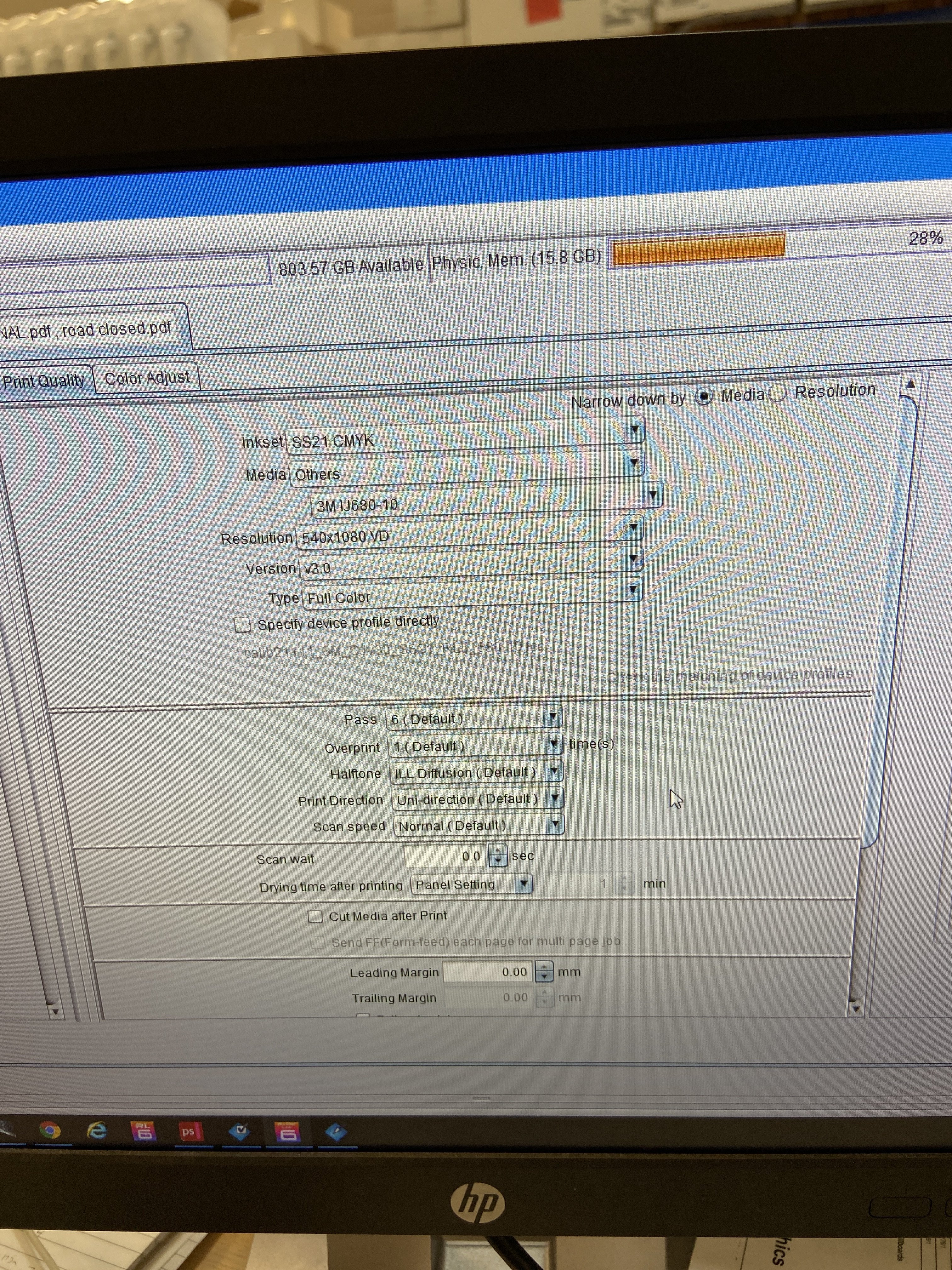

yes I ripped the files. It gives all the usual ink consumption etc but just doesn’t show an estimated print time. (As per solventinkjet’s photo)
Even on rasterlink 5 I could look at the job queue and it would tell me how long a job has been running and how long it should run for.
