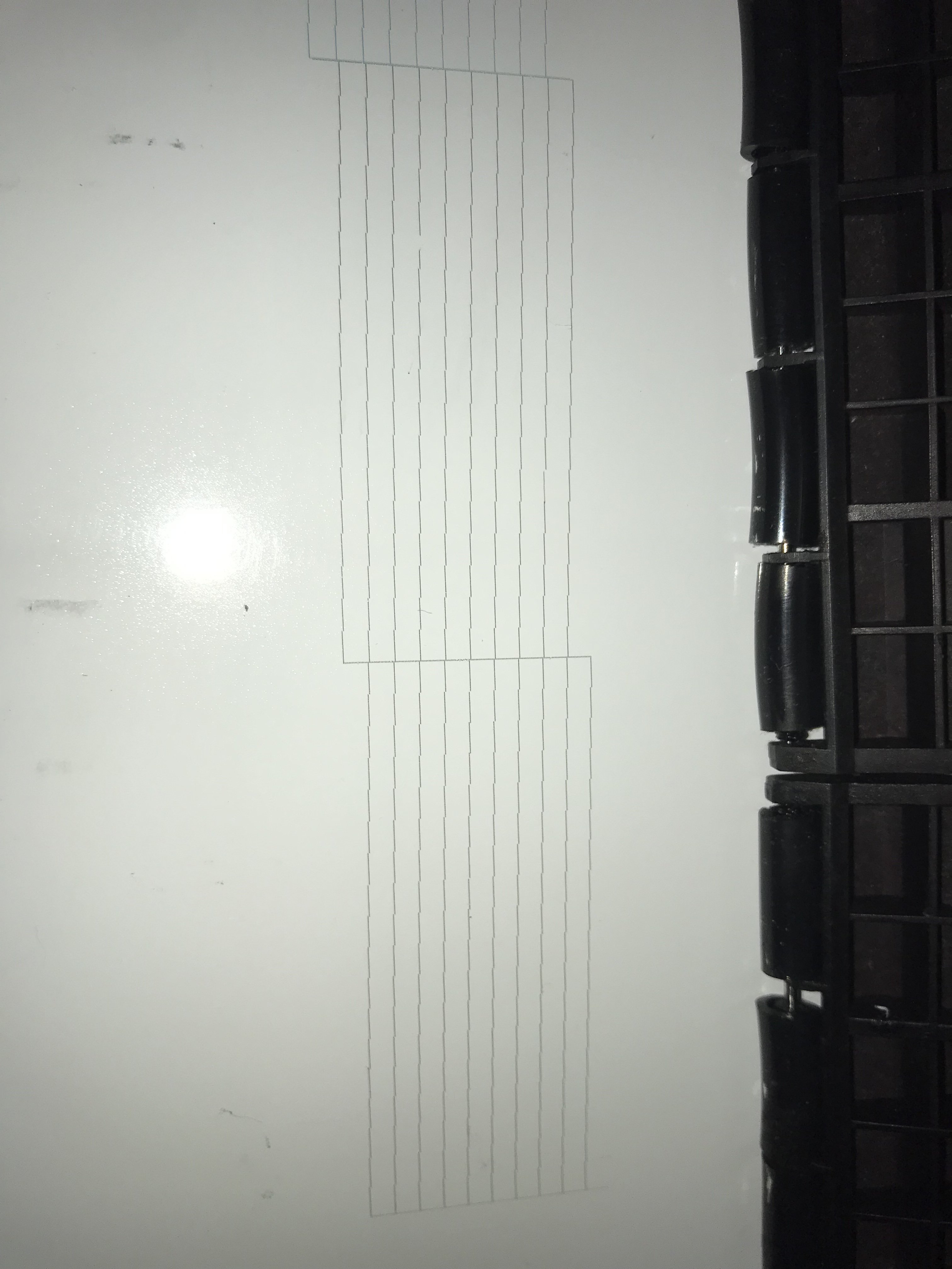

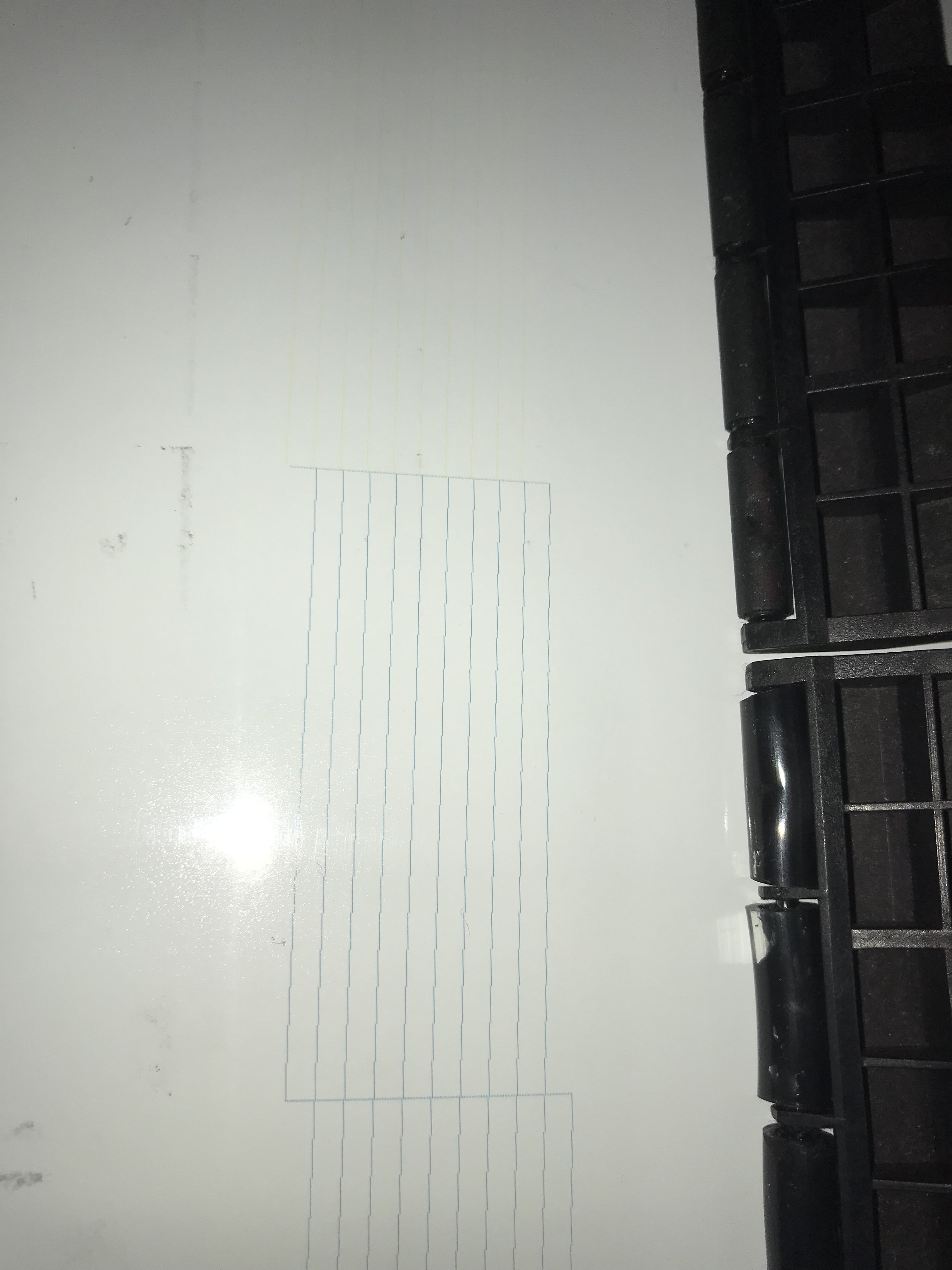

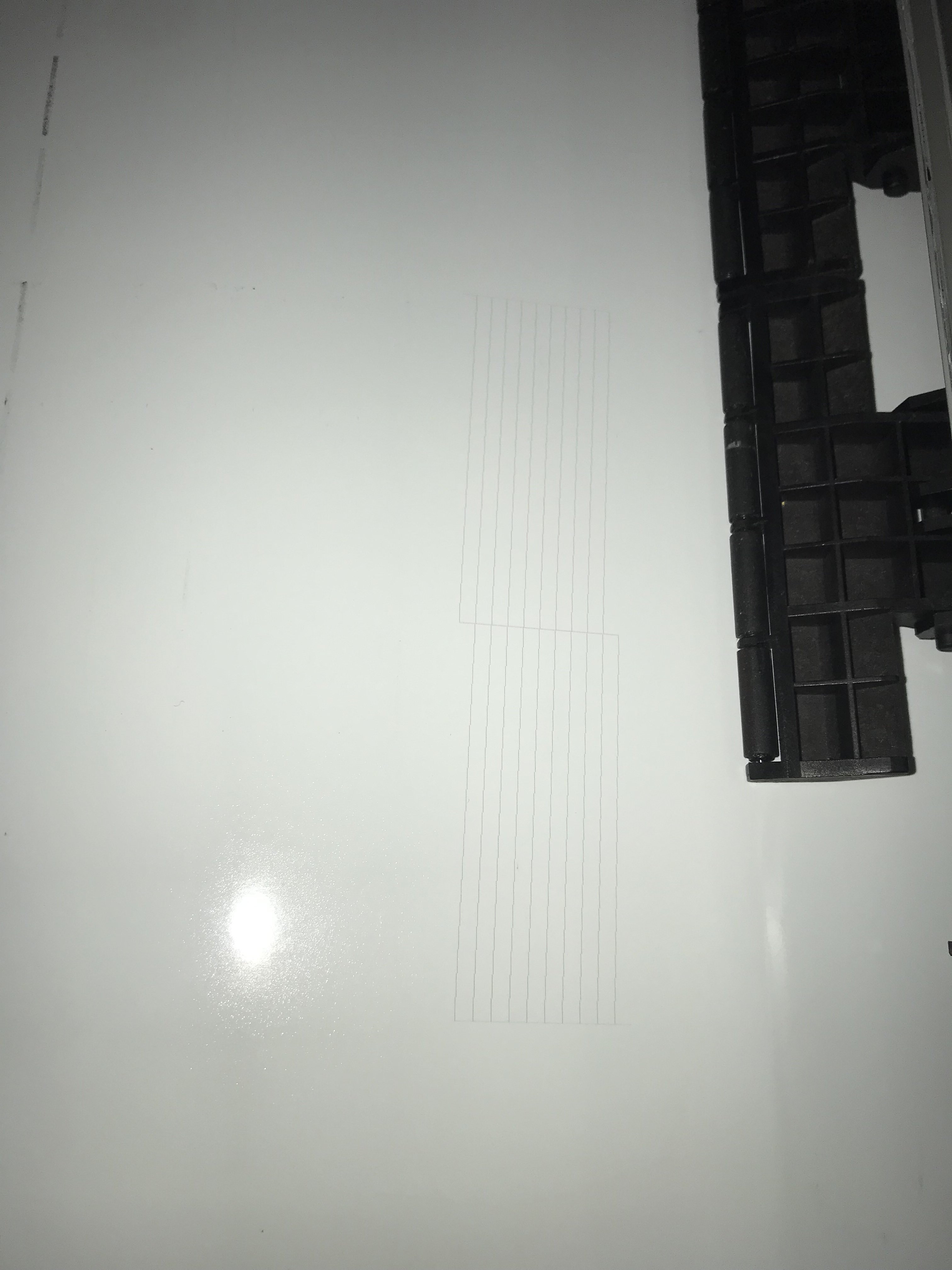

I attached a couple images of the nozzle check
Can someone confirm from the pics that’s the issue? Is there Any links on how to set this head correctly ? He also said I need to enter in the new head rank

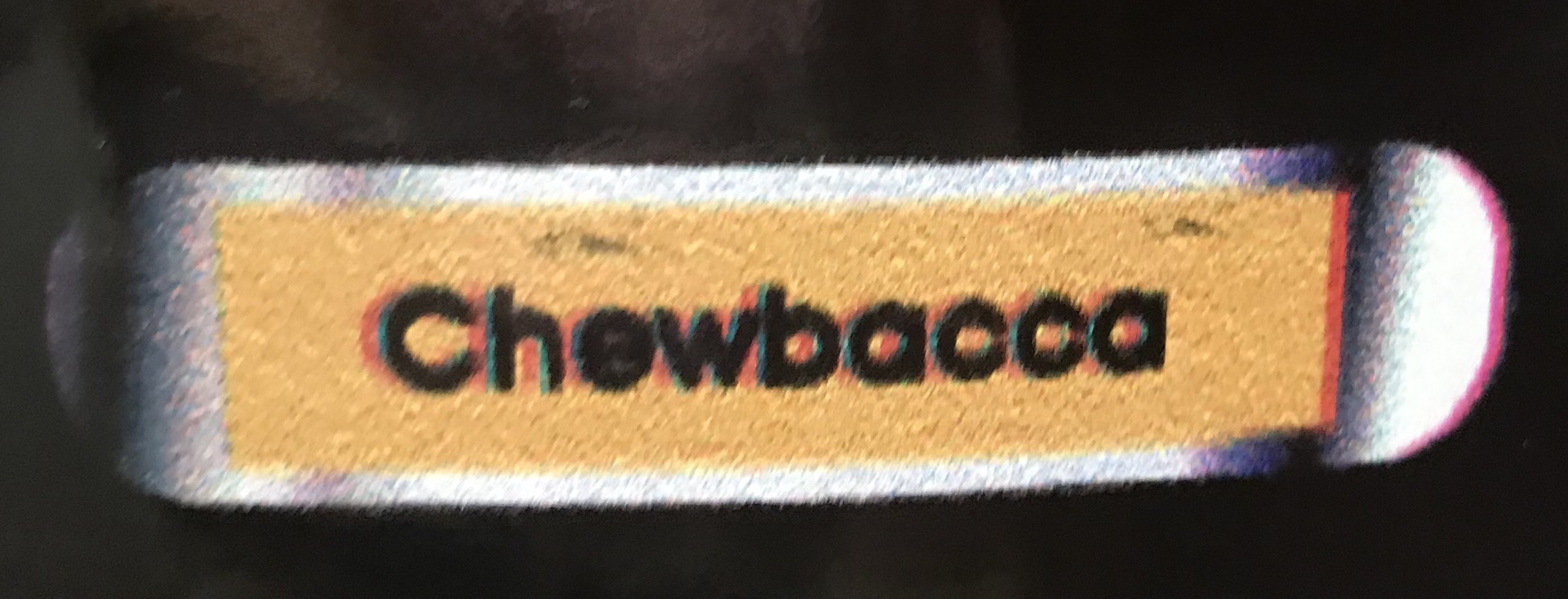

midnightmadman
If you look at this print, the red you see is not supposed to be there
Anyone know what that is ??
