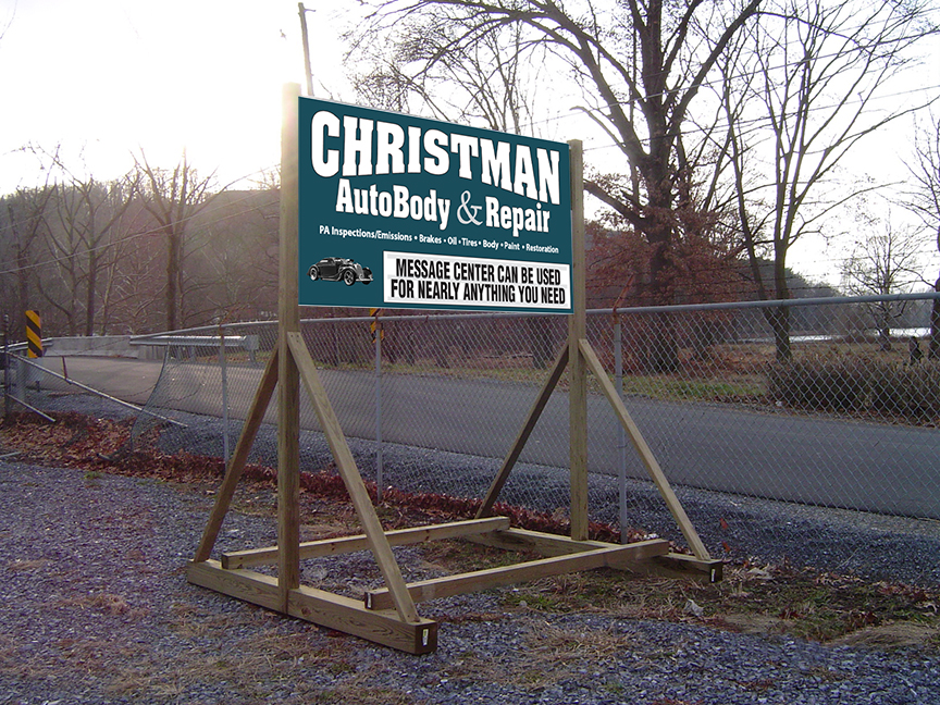

Yep, this one is 10' to the top. Assembled on the property. No holes to be dug, so easy to transport.
I would definitely put some weights on the "outriggers"--wind can easily flip a sign that high up. If the sled is on ground (vs concrete) we use the threaded anchors people put in their yard to tie up their dog's leash. You can buy them at any home center, and they're cheap. Then cable or chain the sign down.
:thumb:
That particular sign has been there quite a few years. We have rebar going down I think 24" or 30" on all four corners. The weight connected with that thing will never fall over and if it does, you'll be having more problems on your hands than a sign blowing over.
Easy to store.
The side cross members come off. The two end upside down Ts come off and one sign with stand will take up maybe a section against the wall 8' wide by 10' tall and stick out about 30". We generally have several of them in the shop for various customers. We're down to one set. Everything is for sale in these parts, with nothing being sold. The countryside is littered with real estate signs around here.

We also build the sled signs ...but we call them cradle signs. Depending on the size we also build them in pieces to transport. Very popular in this part of the country for property management groups and short term advertising.
