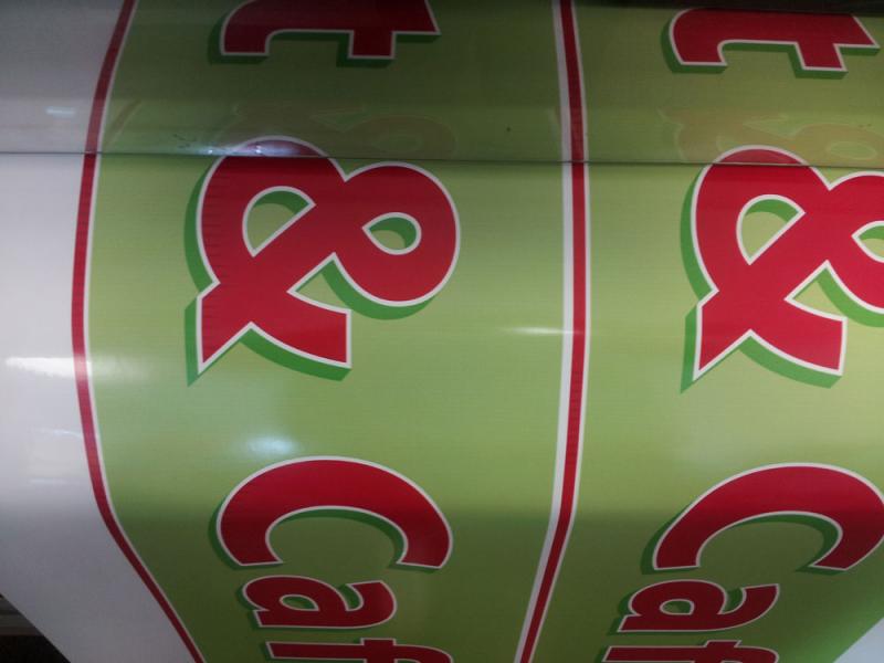

    I have banding on my gs6000, but only in red. Does anyone have a suggestion?

    post a nozzle test - guessing you have nozzles out in magenta

    I do a nozzle check, it comes out with 3 nozzles missing, then I clean, do another, and repeat...everytime I do a nozzle check, it seems like more nozzles are missing.

    perhaps an issue with the captop...

    hers a pic, please help
    this is what it does...only on the left

    You have black ink weeping up into the magenta somehow it gets a little bit then blasts it out in the first inch. i am not sure how it is getting it on every line maybe the head is touching something on every stroke
