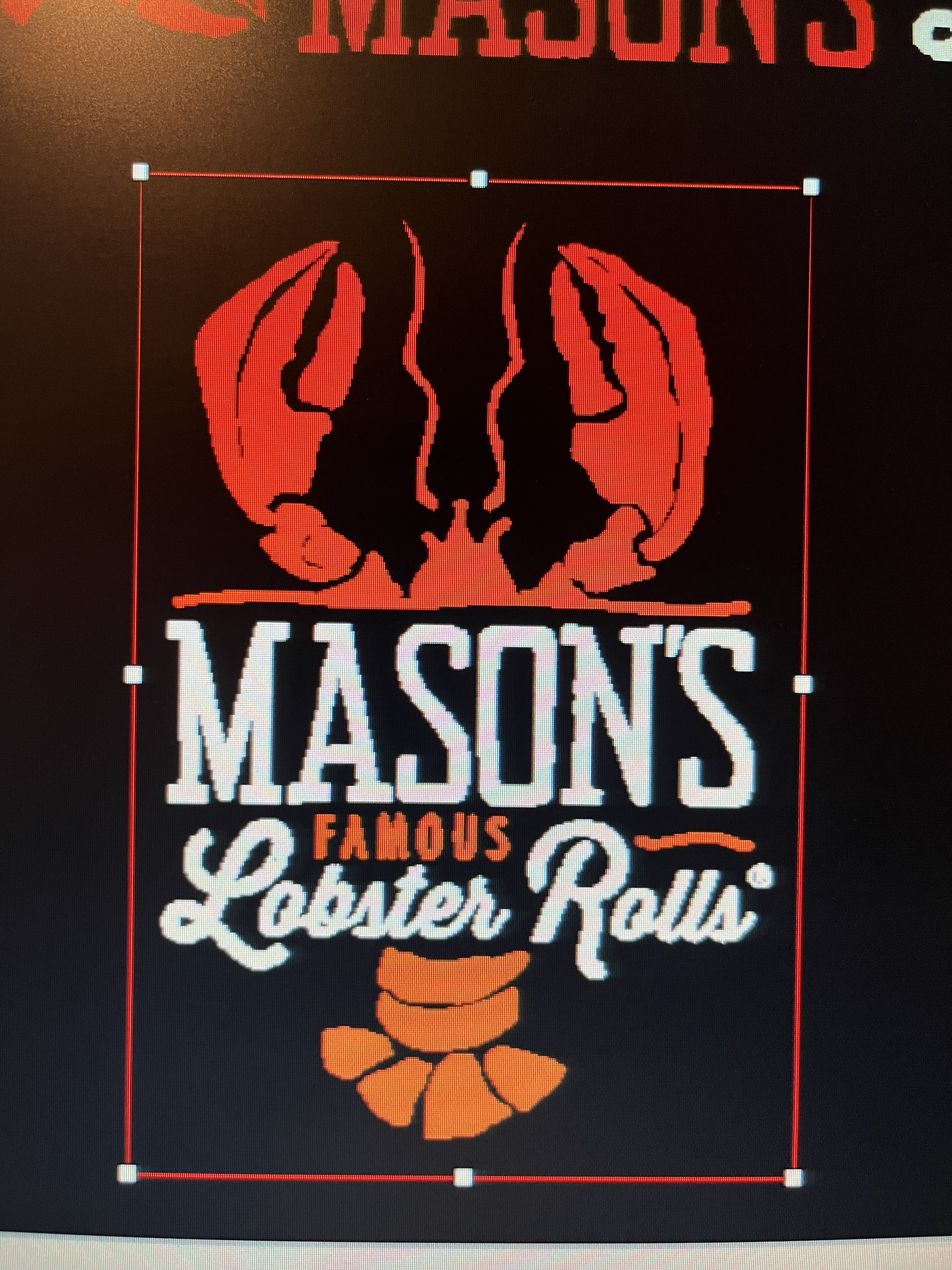

Hey y'all, I haven't been on the form for years. But I've been fighting issue and I'm over it. When trying to open a EPS graphic a lot of times sent by customer it has an outline around it that I can't remove. I can only select the box itself and nothing contained inside of the box to adjust. I am using a very old version of flex sign, 7.6. I cut the image just fine so I know it's vector/EPS but not being able to change the colors of certain things inside of a design is aggravating. I've been doing it the hard way by cutting the image and scanning it back in and cleaning it up. But then certain files I can select everything like I want. Any help please, thanks

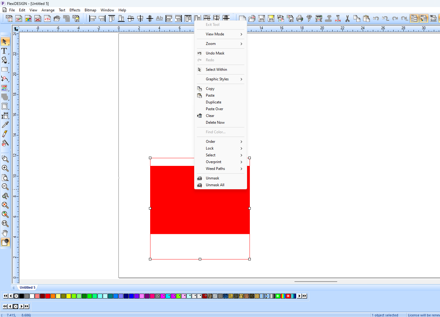

Try right-clicking the object and seeing if there is an unmask option there. On my version of Flexi it is at the bottom of the flyout menu.

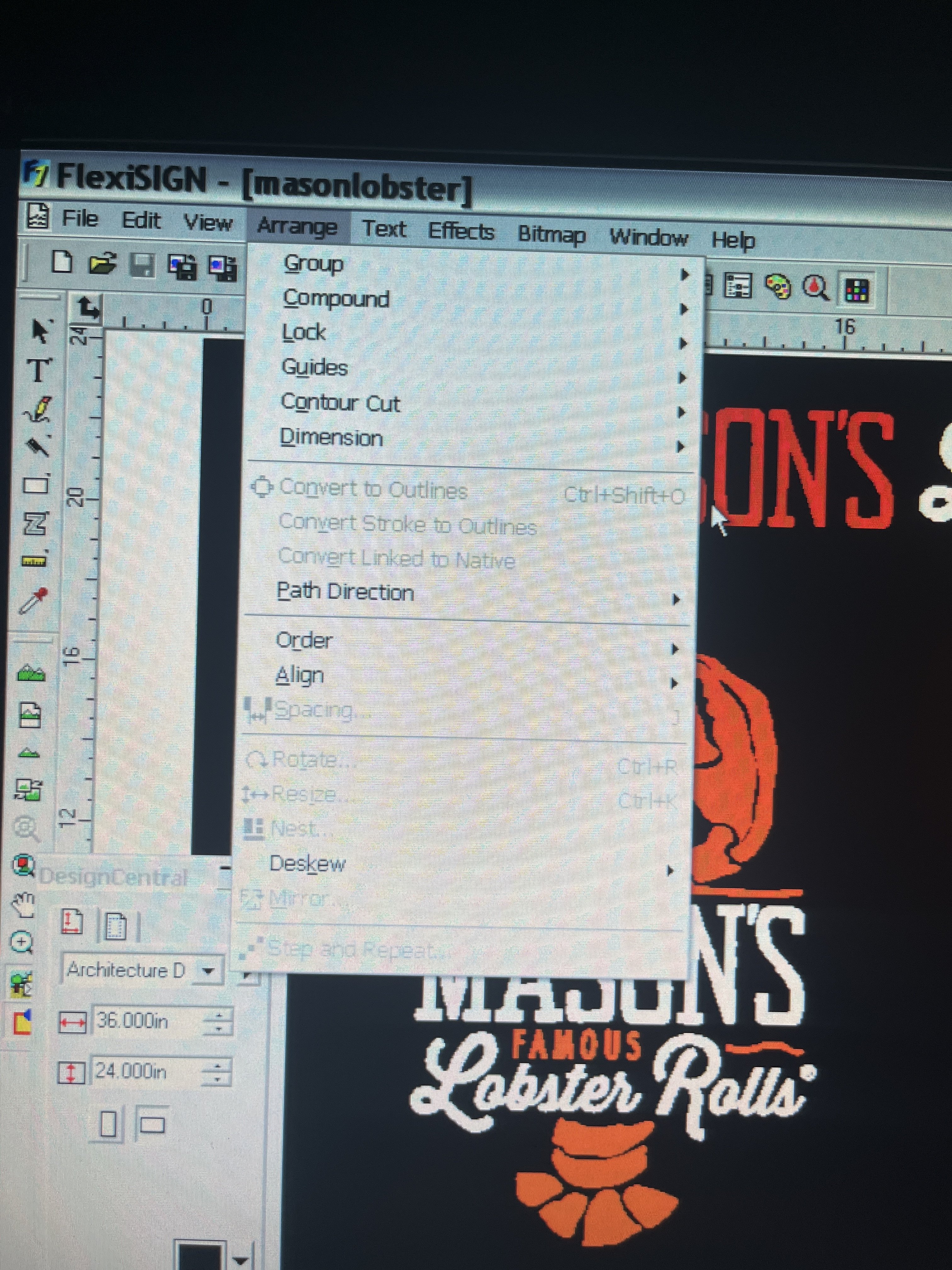

You don't have it under the Arrange menu? Keyboard shortcut CTRL+D

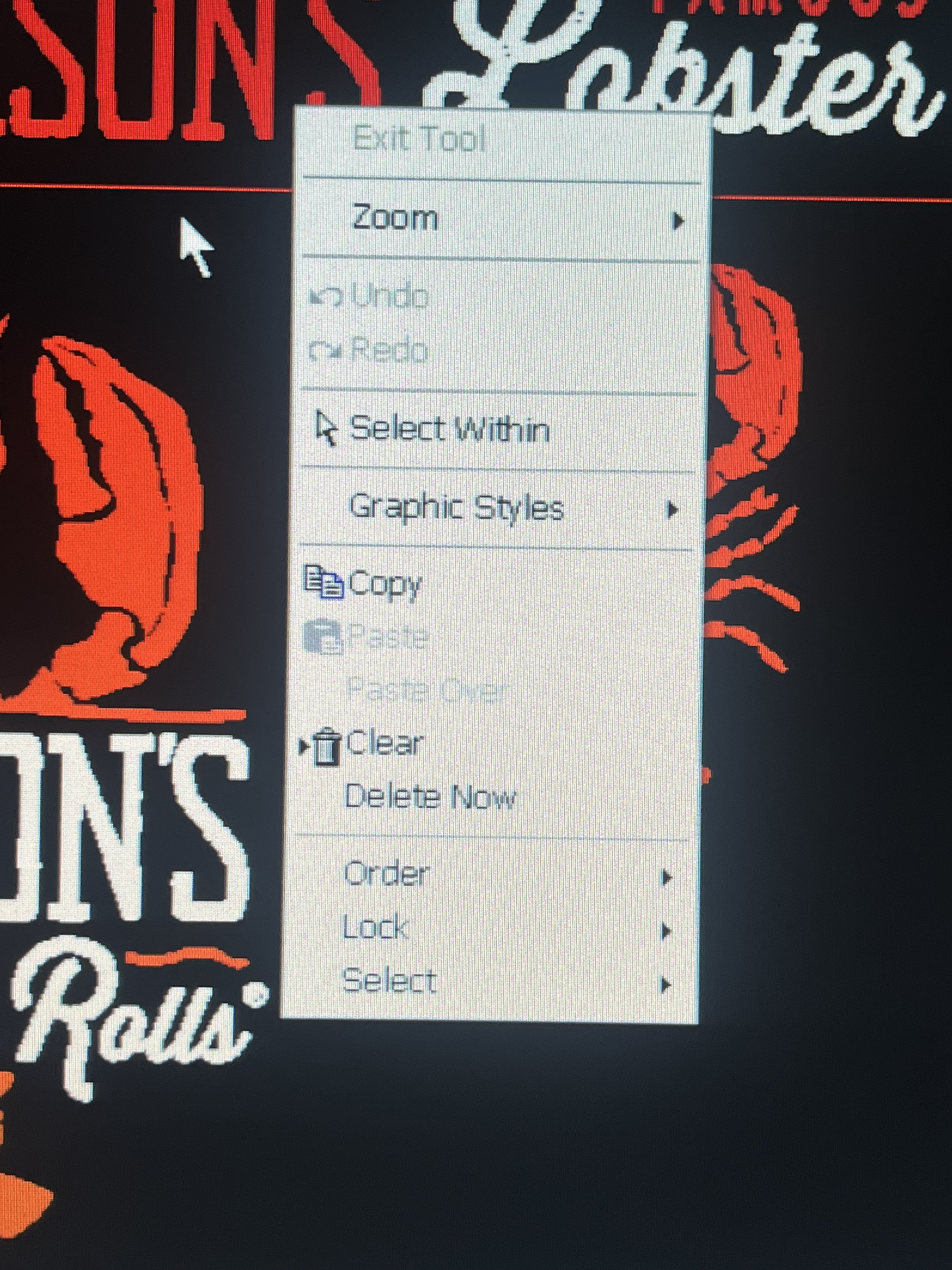

No it's not under the arrange tab. And when I went to workspace I don't see flexiI'm using default which I assume is flexI

It's not just this logo, trust me it is vector because it cuts fine, I can't convert to wireframe because it won't let me do anything with it but cut
