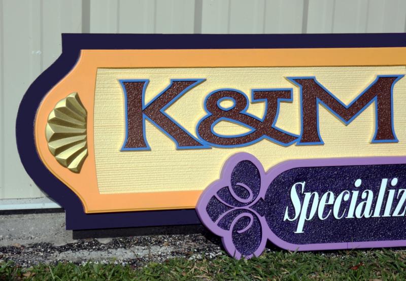

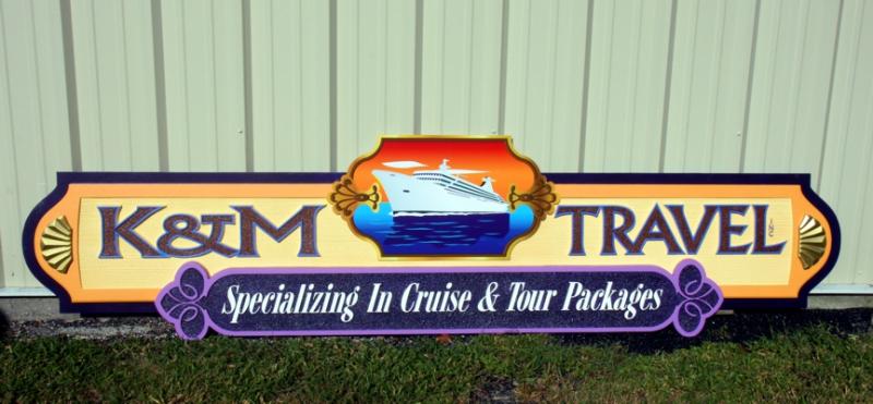

I made this sign ten years ago and it should have been repainted at least three years ago. It was nearly gone beyond repair as some of the paint on the HDU was gone, enough that the UV was starting to degrade some of the HDU in places. The client didn't want to spend money any sooner than he had to on getting it refinished. Ten years of direct sun in Florida with the sign facing south is pushing it.
Anyway, took the sign down, pressure washed it. Total re-prime and repaint and looks good as new. Just have to re install it once they finish painting the exterior of his building. Not sure who will be doing it in another ten years time. I hope I'm doing something else by then!

Thanks Wayne, truth be told, it looks better than the first time around. I tweaked the colors a little for stronger contrast...

Very nice job, I was wondering if you could elaborate a little on the refinishing process you used and what paint was originally used and what paint you refinished with.
SignManiac
Some of the original paint work was done with acrylic latex along with 1-shot enamel. The artwork was printed on an old encad and clear coated. The print was pretty well shot after five year and would have been easy and cheap to reprint, but the client didn't care.
This time, I pressure washed and sanded everything, then laid down two coats of primer. From there we put between 2-3 finish coats of each color. The digital print this time was done on a Roland SolJet with two good coats of UV clear. Originally I gilded the shells carvings with 23k gold leaf. This time I used a Krylon metallic gold and clear coated these as well to seal them so they will not tarnish and turn to a dark bronze.
