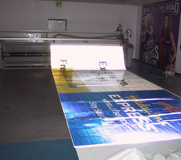

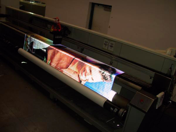

The Oracal/Reflexite material can be ordered in 34" wide rolls as special order for large quantities (5,000 sq ft is in that range). I used it for street banners back in 1999, it is 16 oz/yd (heavy) and one sided, so you have to weld the two sections together back to back, but it worked fine. It is solvent and eco-solvent capable, but I cant speak for latex. It is pricey compared to chinese material ($6 psf vs $1 psf), as its engineered to be a rollup road sign for long term use in harsh conditions and much better optics. Grimco may carry a version of the chinese stuff.. "Optima reflective banner", as they just took over advantage sign supply, and advantage was an optima dealer. But that was a 54" media and was retail at $.78/psf
for double sided, you'll have the glue or weld the faces together, YOU CANT SEW IT - sewing the reflexite type media will cause water incursions into the cells and they will go dark on first rain or dew. It's basically a sheet of microprism vinyl welded to a base vinyl. Has lots of pockets of microprism cells.
Its a very durable material, Ive used this type of reflective for years to make flexible billboard faces - (I invented the first one for Outdoor Sys tems in 1998)..
