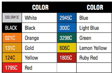

3M 680CR comes in two (2) blues: Light Blue and Blue. Attached is the best way to show the shades in PMS colors. What reflective are yyo looking to print this on?
