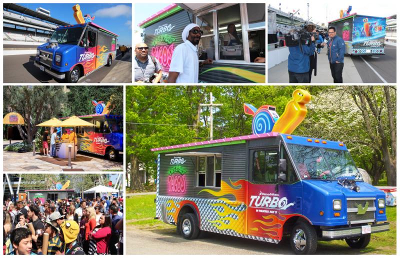

Echoing Pro Wraps here. I use 680cr for all of my reflective jobs it has air egress so it will go down much smoother. It is also easier to put down for an overlay or for outlining.
The attached photo has 680cr over all of the neon (on the truck and snail).
