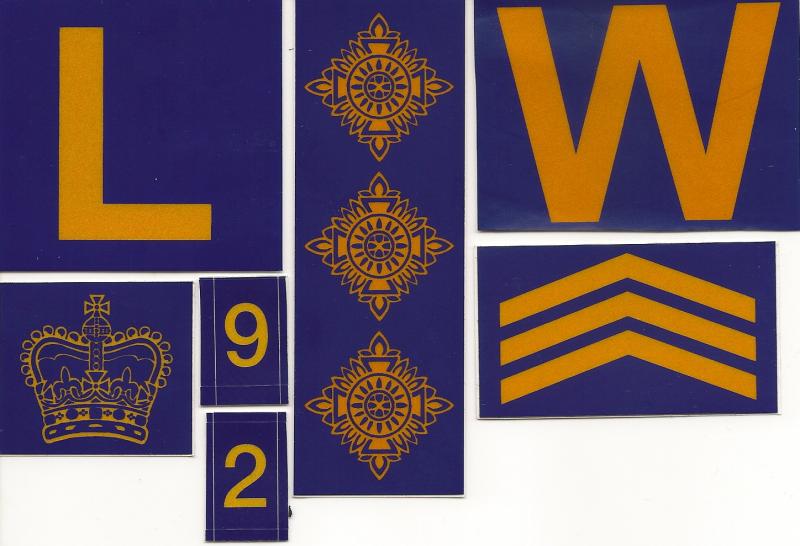

I ordered 10 metres of 280i which arrived today - blimey, it's thick stuff & expensive!!
This is the sort of thing I'll be printing - I plan on laying the navy first followed by the orange letter (I'm doing just the L & W first. As the letter won't be cut what is the best method to use so there's no white peeking through at the edges of the letter? I cant' use bleed as there's no cut, so is it choke? I'm guessing I use bleed where the perimeter of the navy square is cut?
Couple of questions on cutting:
What pressure setting do you use to cut this stuff?
Do I need to use a 60deg blade?
For some reason I don't get instant notifications when someone replies, but I will check back :)
Thanks again for your help.
John

yeah choke the yellow with the navy - I would probably print the yellow first and then the navy with choke applied
60deg blade, slow - should work fine (esp. since its just squares)
I'm not sure on the edge printing capabilities, but we would print all the colors at once and there would be no problem of registration.
I believe you put the colors in one at a time, so as long as your vinyl isn't shifting, there shouldn't be any problems.
If you think there will be problems, perhaps you could print the gold first with a little bleed [overlap] and trap the blue overtop.
Your big problem is gonna be when you have to cut that little frilly stuff. That's gonna be a nightmare and a half.

I've been running a few off as a test on ordinary vinyl Navy first with a .35 bleed on the square cut followed by the orange with a .35 choke.
@ Gino
Fortunately the cuts are all squares :)
