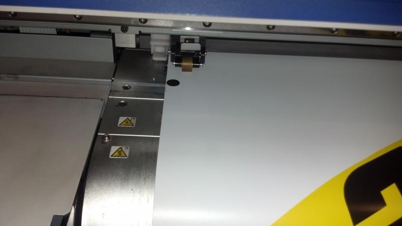

Reg marks printing problem..shifted to the left of center, past pinch roller..HELP
TresL
I've contacted Roland and waiting to hear back.
My reg marks are printing to the left of the left roller.
Get Media gives correct size.
TresL
also notice print starts to get blurry about 3' into the print. Like it's Shearing to the left

If I restart the printer(full power & standby) Printer will start printing normal for around 3'
Jester1167
Your encoder strip is dirty or damaged if the image shifts to the left as your facing the printer. I would clean it gently with a microfiber cloth. If that doesnt work the encoder strip is two sided and you can flip it over.
TresL
Found a small dust bunny hiding on it, I'll test and let you know. Thanks for the help so far.
TresL
So far, extra cleaning of the encoder strip has helped, I still need to run a 10' long piece to verify. AGAIN, THANKS FOR THE HELP!!!!
