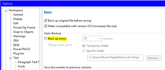

    Another point is the auto save function under options. I turned mine off. If I'm working on a large file and after 20min it'll do an auto save and can take like 30 seconds or so to finish before I can move on. I think it's just saving the backup not your actual file, you'll have to do that on your own.

    Thanks for the responses. The computer has a i5 processor and 16gb of ram, Win7 Professional. I'll check the autosave setting. Interesting comment about the hard drive - it's just odd that it only seems to be in Coreldraw?
