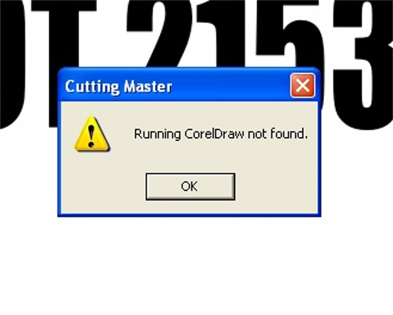

    I'm at it again.
    Inadvertently installed an OEM Corel X4.
    I've uninstalled it but now I can't plot from Corel 12 to my Graphtec.
    I get the message from Cutting Master (which I just reinstalled)
    as follows.
    "Running Corel Not Found"
    Pleaseeee help?

  7. J Hill Designs
    15,549
    19
    Sep 24, 2004
    might have to reisntall 12 - probably the x4 uninstall took away some goodies used by cdr12
  8. OldPaint
    OldPaint Major Contributor
    you need to uninstall/reinstall cutting software. when you wiped corel it doesnt delete plotter driver. when you reinstalled corel, it dont find the driver, you have to clean h/d of any graphtec driver THEN.....after corel is installed reinstall graphtec drivers.

    Reinstalled 12 and EUREKA!
    Thanks fellas.
